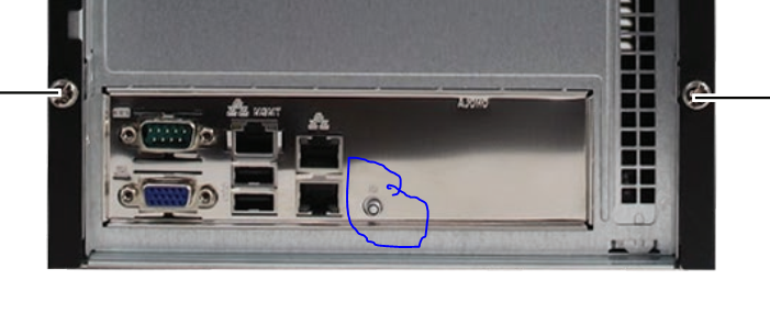

The LED with the "i" next to it is the "identify" LED - that is lit up by pressing the little button on the back of the unit to the right of the two Ethernet ports. Lighting up mine is not dependent on the network cable being plugged in ...

Ref the red light - reach over to the back of your server and give the little button
a press - on mine that would shut it off.

Thanks, Redcoast. Found the button, but unfortunately pressing it did not make the red light go off.

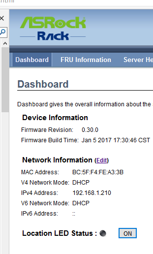

OK, then open the IPMI Dashboard
if the Location LED status has a flashing button next to it, click OFF to shut it off.

Thanks, Redcoat. Unfortunately, that also did not address the problem. I decided not to worry about it as it does not seem to impact functionality.
