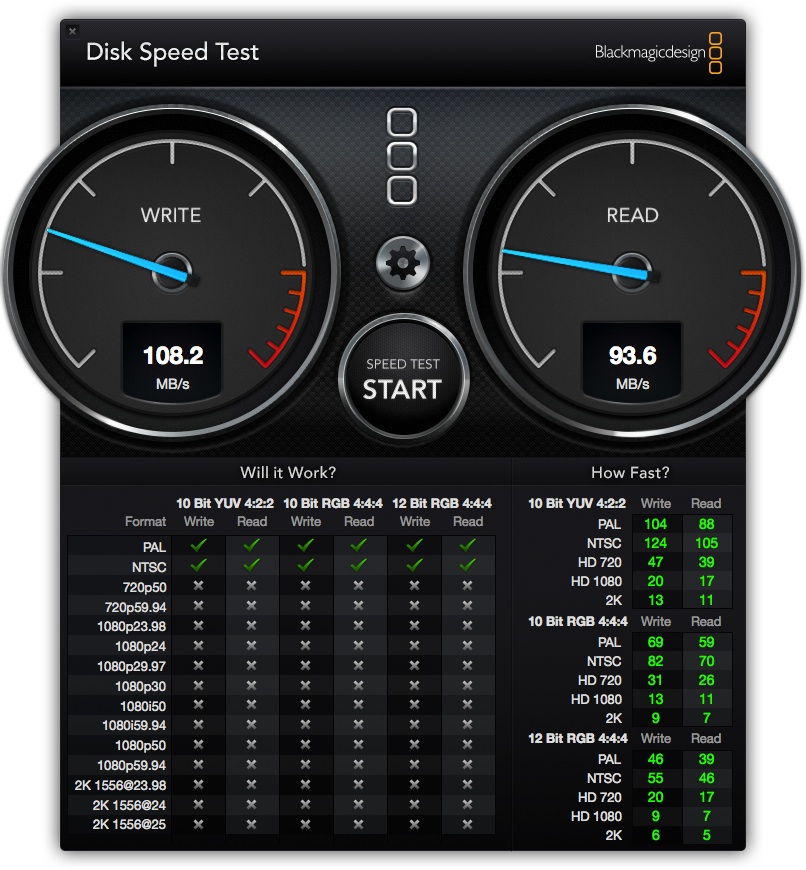

The 108MB/s is internal speed of my computer, not the FreeNAS. I have a Mac Mini with internal 2.5" laptop drives. Straight disc performance, no striping, etc. FreeNAS RAIDZ1 does internal transfer rates of 1.56GB/s.

Disk Speed Test results. See attached .jpg. I don't know the details of what is actually being tested or how. I have selected the highest stress option for the test although the results don't seem to change much low-to-high stress.
I will do a dd of a real file from the computer to FreeNAS, with compression as is, as a reference.
