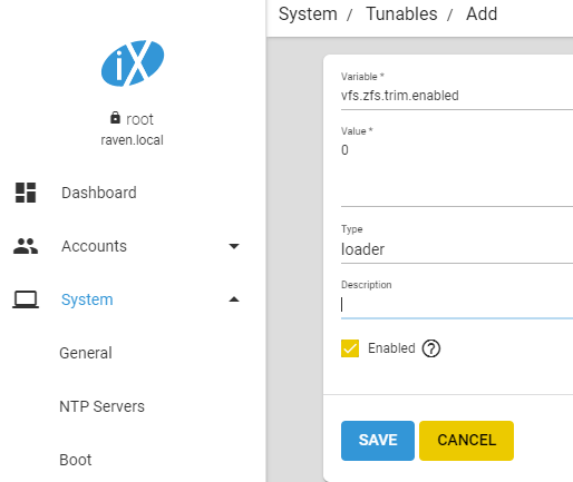

Sorry for the very Newbie question. I have a similar problem in that TRIM is causing my new SSD (boot pool) to be flagged as degraded. I think that I need to add vfs.zfs.trim.enabled=0 to the sysctl.conf but it doesn't write out in the Shell. How do I actually change tunables?
Patrick M. Hausen
Nov 25, 2013
7,776
System -> Tunables in the UI. Probably type "loader" for this one.

No luck with either "loader" or "sysctl" types ... Thanks anyway. Will keep tinkering.
What precisely did you enter? Care to share a screenshot? BTW loader is correct, see @Samuel Tai's post above.
Samuel Tai
Apr 24, 2020
5,399
Note loader tunables only take effect on the next reboot. Under System->Tunables, click the Add button, and fill out the ensuing dialog like this:
Click Save, and reboot.

Thanks. The example helped and it worked after the 3rd save and reboot. Now "sysctl vfs.zfs.trim" returns as enabled=0, but the disk is still flagged as degraded. Scrubbed a couple of times and it doesn't seem to have changed status, so I guess that maybe the disk is actually degraded, or just incompatible with FreeNAS. Although at less than a month in the machine from new, I am a little surprised. It still seems to boot fine, so I am not sure what the problem is. Thanks again for the help.
