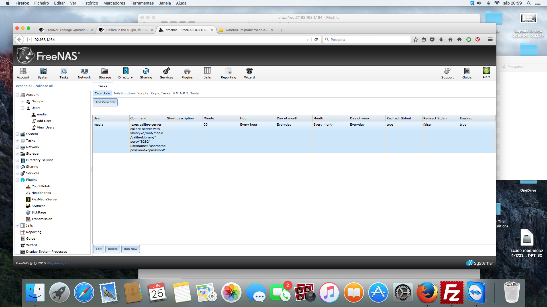

The library="/mnt" should work fine, so when you run the Cron task you should be able to access calibre from the jail IP on port 8282 e.g. http://jail.ip:8282

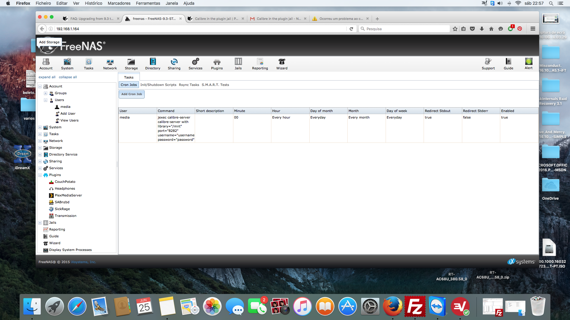

yes, my calibre location is /mnt/tank/media/calibreLibrary, created the cron task but not working
i think was created correct
adrianwi
Oct 15, 2013
1,231
You're missing some -- too! Mine looks like this:
jexec calibre-server calibre-server --with-library="/mnt" --port="8282" --username="username" --password="password"
I'd restart the jail, enter the jail shell and check that /mnt displays your calibre library, and if it does, running the edited cron task from the WUI might work.

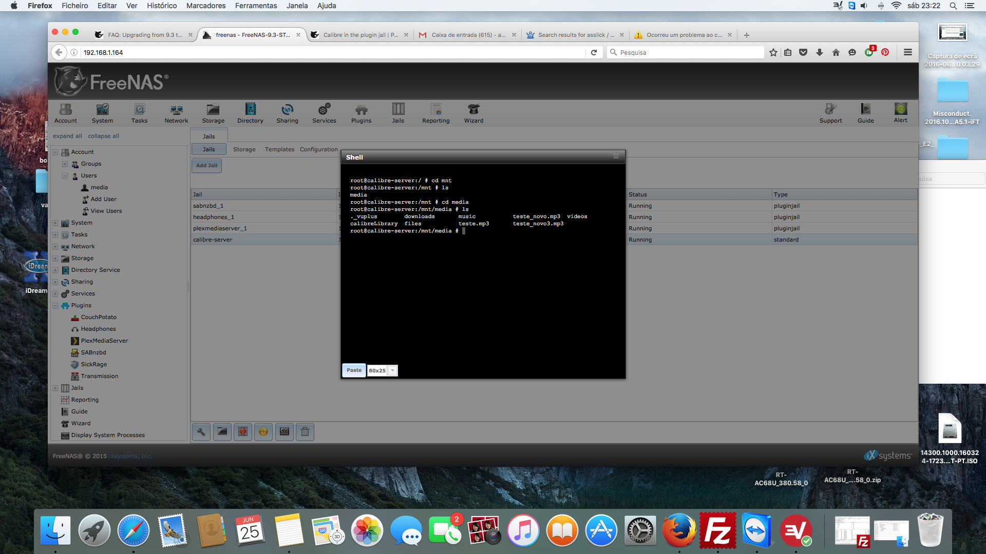

this is the jail shell
adrianwi
Oct 15, 2013
1,231
Then it should work with:
jexec calibre-server calibre-server --with-library="/mnt/media/calibreLibrary" --port="8282" --username="username" --password="password"
Although you probably started the calibre server with the previous command (without -- flags) so make sure you restart the jail (by clicking the yellow circle icon underneath the list of jails)

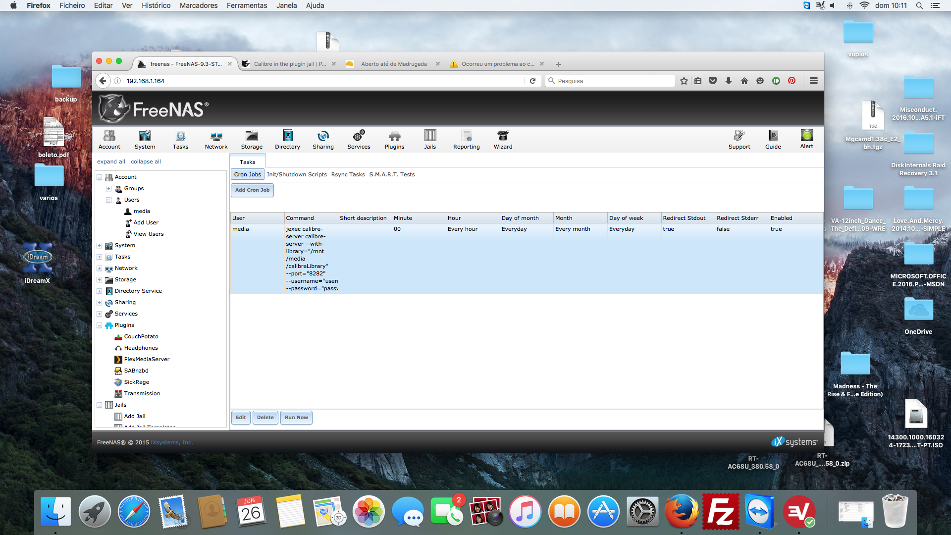

I did exactly has you said, but not working
the cron in attachment
my freenas version is 9.3. Should i update to 9.10?
adrianwi
Oct 15, 2013
1,231
It shouldn't have a one at the start!

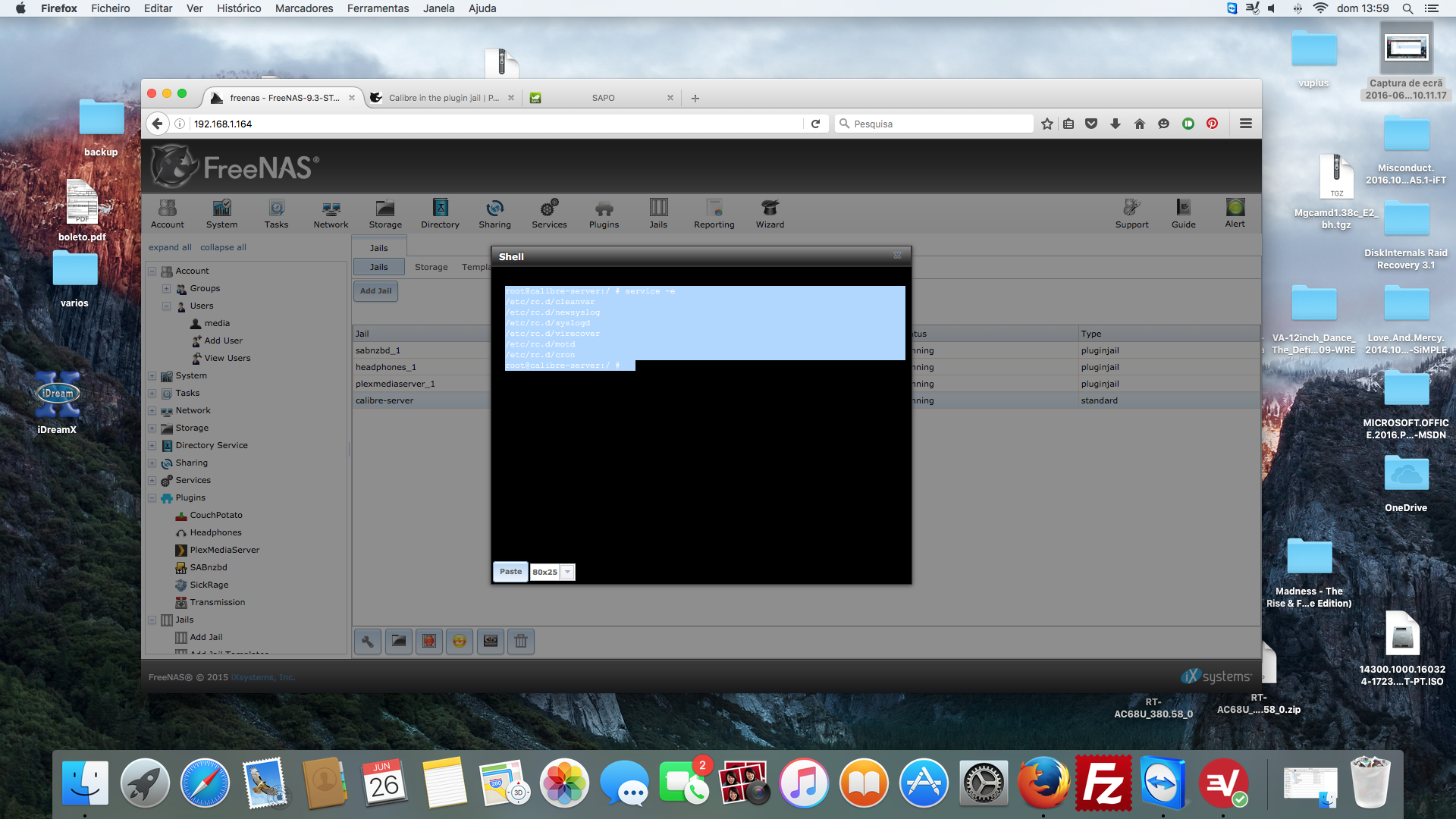

running the comand "pkg upgrade" i have "pkg: skipping unknown key 'messages'. Is normal?
adrianwi
Oct 15, 2013
1,231
Try running pkg update before pkg upgrade.
