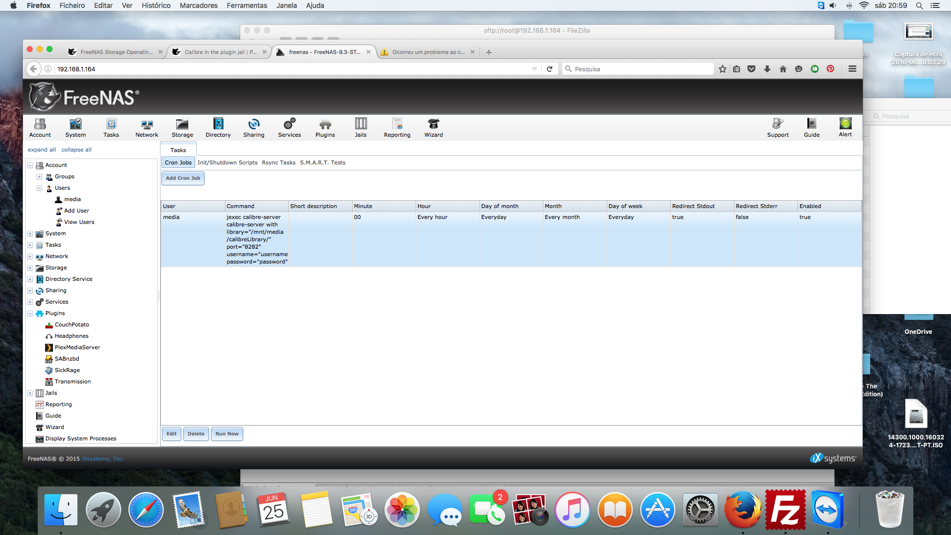

I did this mini tutorial but nothing. Is this cron job ok?
jexec calibre-server calibre-server with library="/mnt/tank/media/calibreLibrary" port="8282" username="username" password="password"
my folder of calibreLibrary: mnt/tank/media
my jails: /mnt/tank/media /mnt/media
The jail i created is: calibre-server

You're running the cron job within the jail, so the library="path" needs to be the name of whatever you mounted in the jail storage.

my jail storage: /mnt/tank/jails
add storage of the jail: source - mnt/tank/media destination - mnt/media
fontes31
Apr 6, 2012
96
this is my cron job
