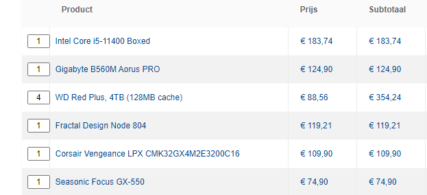

I've an list compiled of parts for the NAS and I think I want to install Truenas scale on it:
I'm posting this cause maybe somebody has something to say about this build that I should be better of with X part of maybe this is good.
Total price of the build is around 1.000 euro.

Generally we recommend server boards, over desktop or gaming boards. Server boards are generally intended to run 24x7 for years, have server targeted hardware, (like leaving off audio but adding IPMI interface). Further, it's not generally recommended to overclock, (CPU or memory), for a server, so a gaming board overclocking feature is not needed.
You can get a successful NAS from many non-server boards, just suggesting you look at server boards from ASrock Rack, Supermicro, Tyan, and even Gigabyte now has server boards;
It's also helpful to post your ZFS pool layout. With 4 x 4TB you basically have 2 options:
  • 4 disks in RAID-Z2, (can loose any 2 disks)
  • 2 x 2 disk Mirrors, (can loose 2 disk, but must be in different Mirrors)
Both give about the same amount of storage, but support different failure conditions.
Some people might suggest RAID-Z1 to get more storage, and that is a valid design. It is just that most of us like our data, intact and available, so we tend to go with extra redundancy, and use RAID-Z2.
Last, using a M.2 NVMe, (even 256GB), as a boot device is perfectly fine. Cheap, reliable and small SSDs, (like 16-32GB), are getting harder to find.

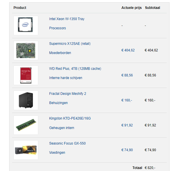

I'm right now got this setup:
This is the H5 LGA 1200 socket
The processor is not listed a price but I can back order it for 330
I'm thinking this is maybe a bit overkill ,

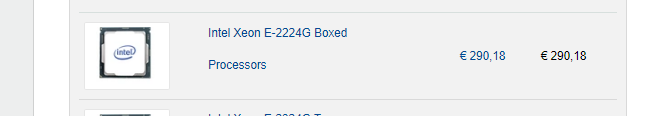

If I go a bit older I get an cheaper motherboard and a lil bit cheaper CPU
LGA 1551 H4 socket
There is sort of 300 euro difference in between setups.
Kinda leaning to the newer CPU socket.
I'll go with the RAID-Z2 setup because the speed is sufficiënt
Any comments on the builds?
Overkill indeed. A NAS does not need the latest and greatest hardware.
Even better: Up to the 9th generation, Core i3 CPUs support ECC. You can replace the E-2224G by an i3-9100, keep ECC memory and save another 100-150 E.
