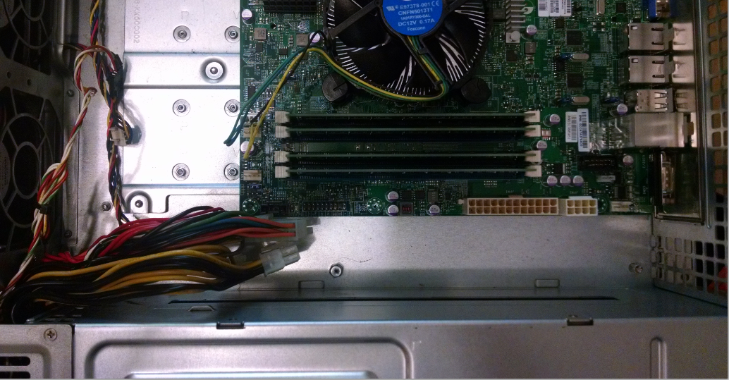

I hit another odd snag while installing the motherboard. The power supply cords from this Supermicro case won't reach the receptacle on the motherboard. Frankly, I don't see how the cords at this length could reach almost any motherboard.
Do I need to get some kind of "extension cord" or something? That isn't something I would think Supermicro would want to encourage, but I'm not seeing how else this would be accomplished.
Do you/can you post photos? All my cords reached my board without issue, and a few other users havent reported this issue either.
You can buy those, but it's weird that they're that short.
Sure, here it is. The cords in that picture are stretched out almost as far as they'll reach with the necessary downward bend. I could maybe another half inch out of them with some tension.
That's a far reach for supermicro to put there 24 and 8 pin... Here's an 8 pin and a 24 pin
mattbbpl
May 30, 2015
237
Thanks guys. I don't have time to order those right now (I told a swimmer I'd swim a 1 mile IM with him today at 4:00 pm), but I'll place my order this evening.
Thanks for linking those, I was having a heck of a time trying to figure out what I'd search for to find them.
