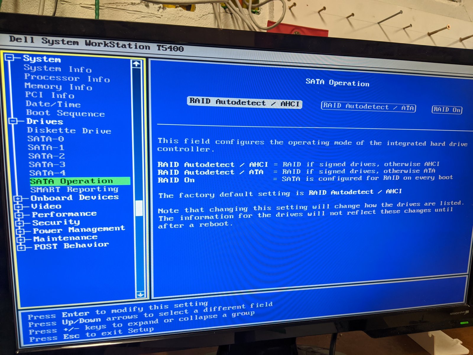

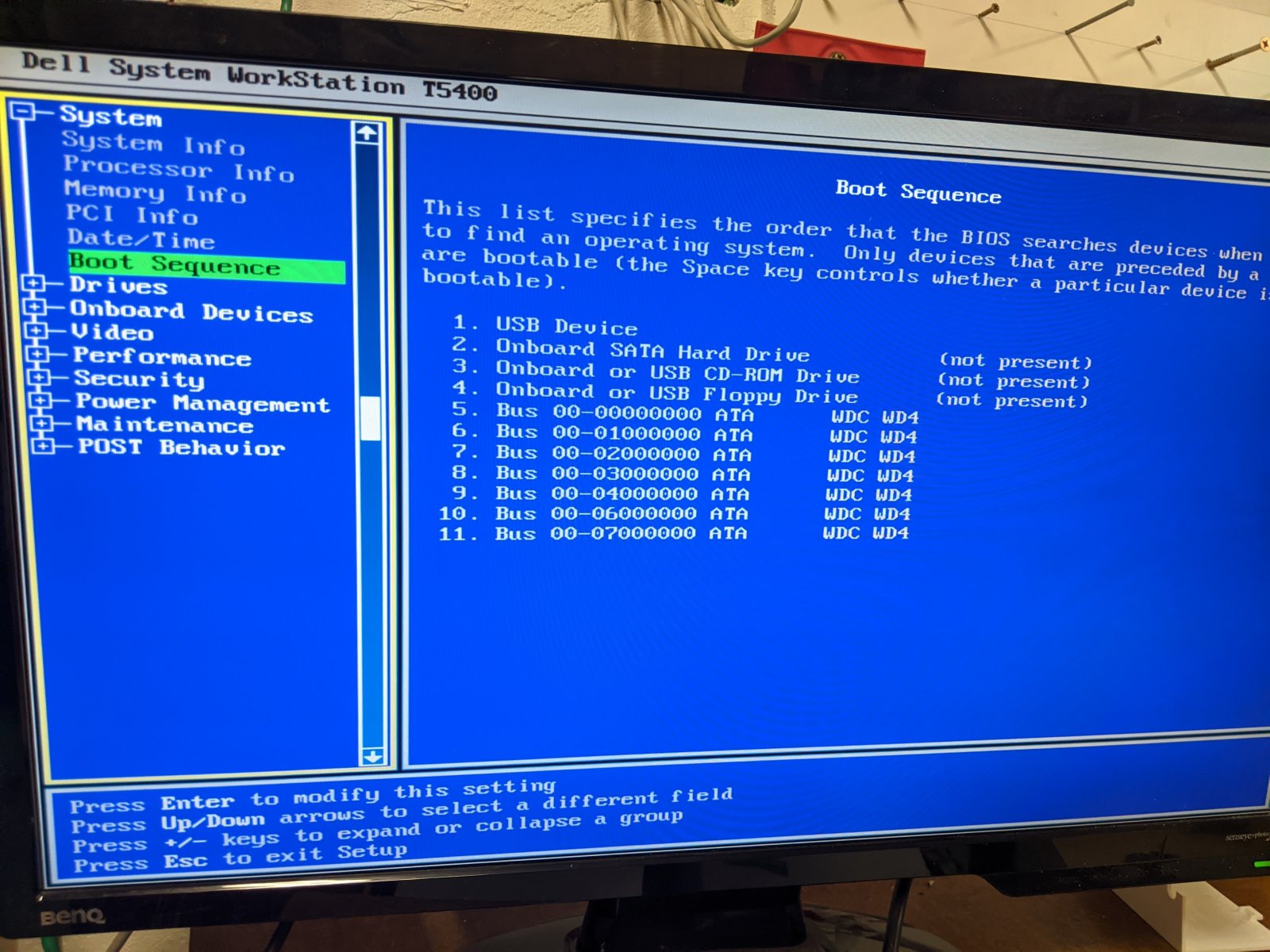

I've read that going into the BIOS and selecting the AHCI option often works but that does not seem to do anything for me. In fact, I can't really find any such setting in the LSI bios. I did find something hinting towards AHCI in the Dell BIOS and that is set, I've tried changing it back and forth but that makes no difference.
I should note that all the WD disks are connected to the LSI MegaRAID controller and I've turned all SATA ports on the motherboard off which is why I'm mostly trying to find AHCI settings in the LSI BIOS.

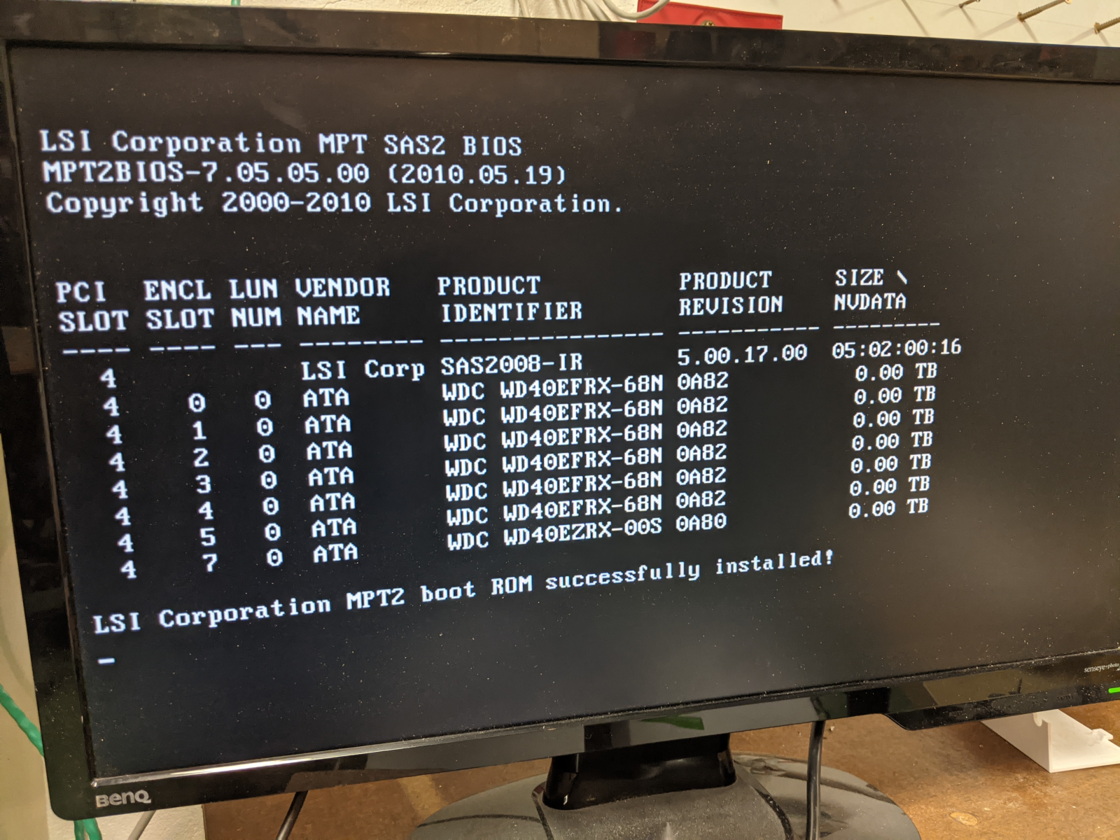

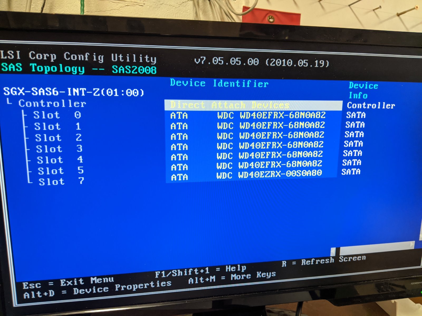

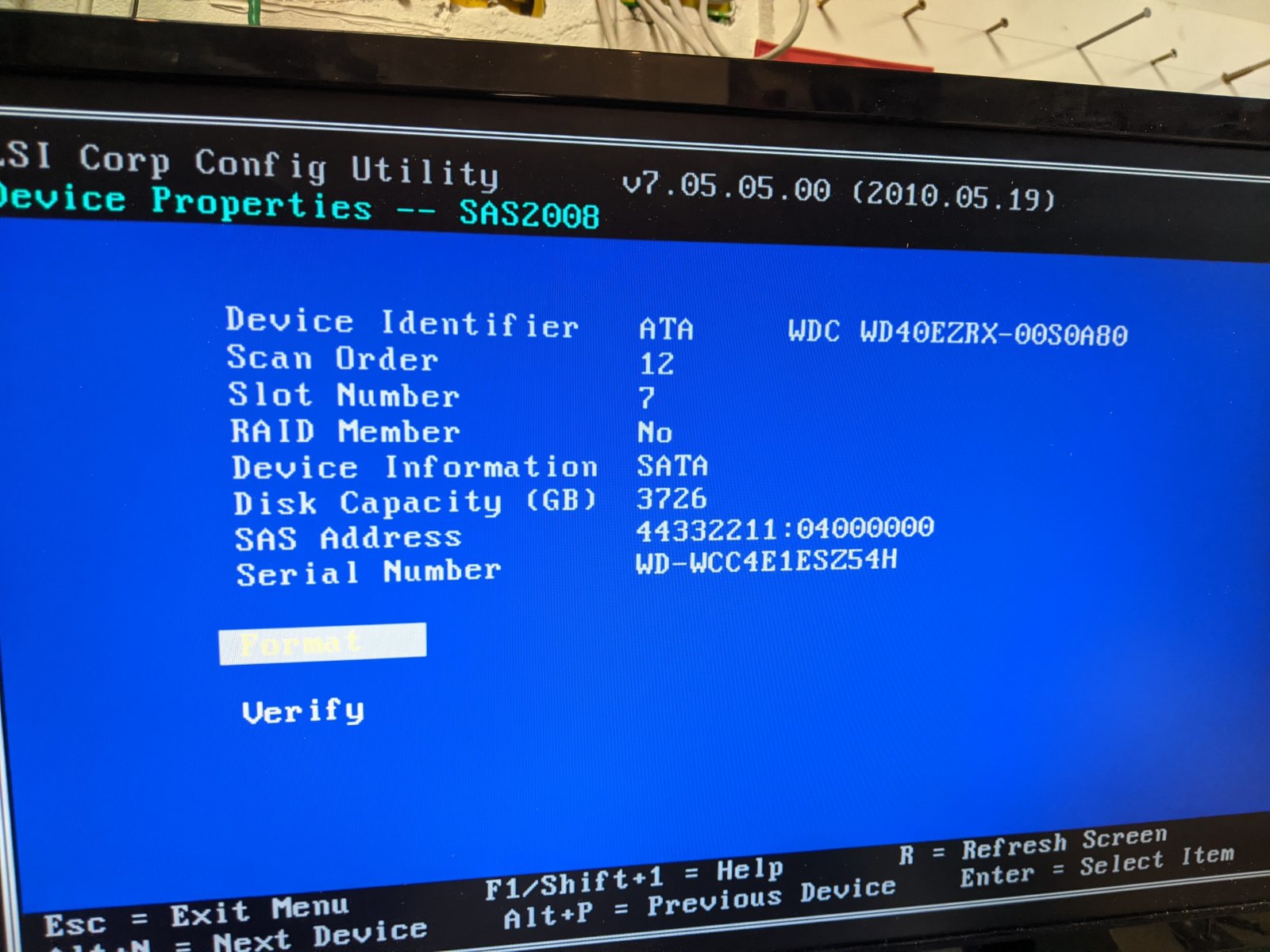

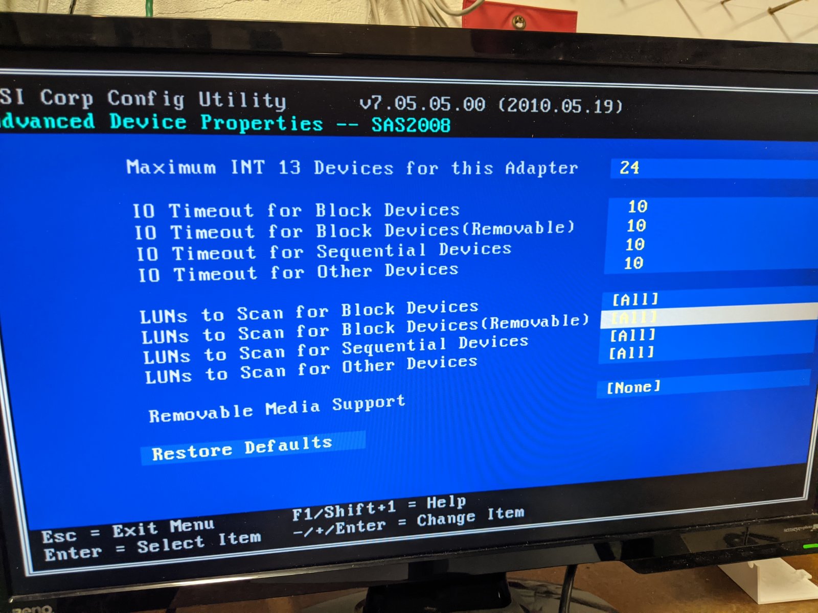

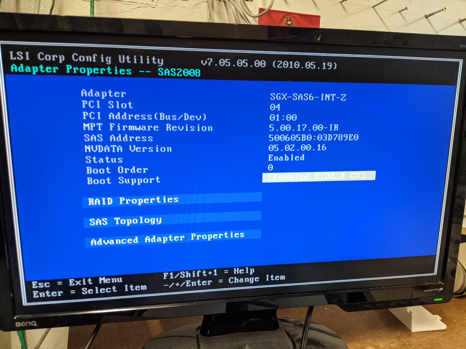

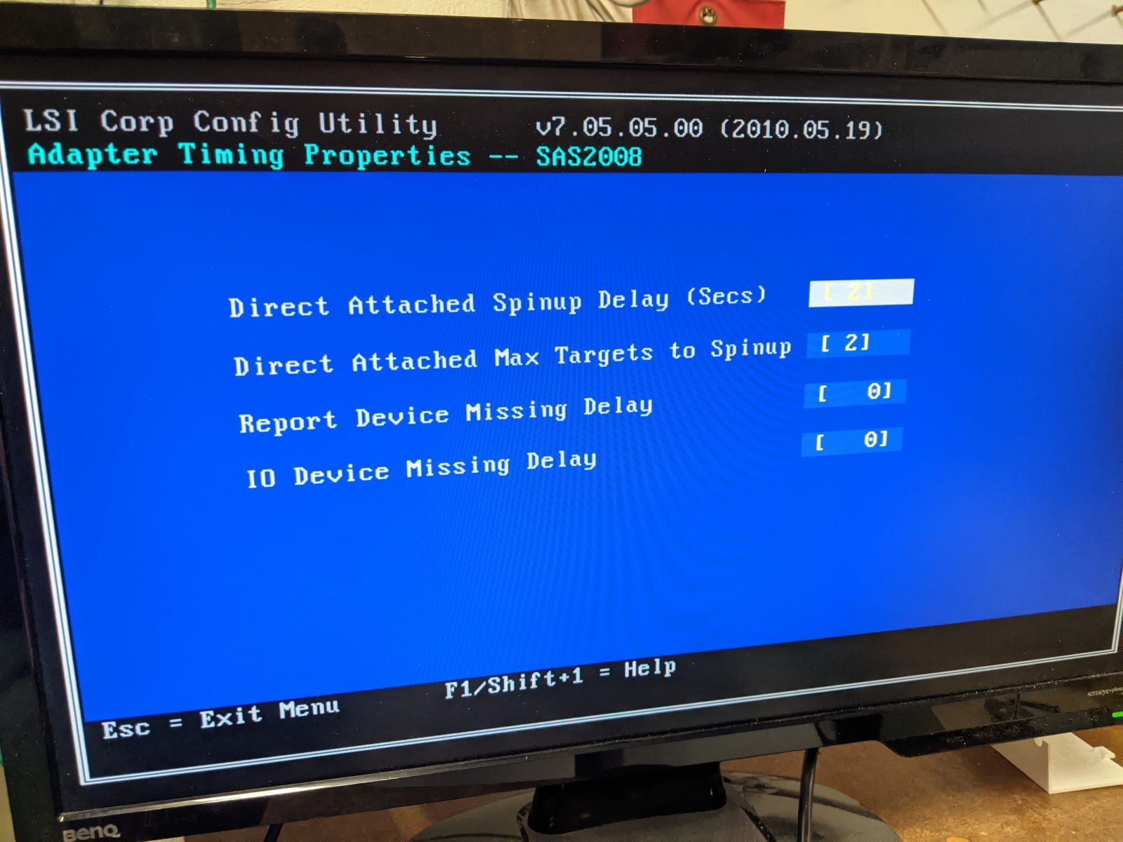

1) The LSI "boot screen" reports all my drives as 0TB in size (attaching a picture of that).

I'm also attaching a bunch of pictures of the screens for the LSI Config Utility as well as the Dell BIOS if that rings any bells for anyone.
