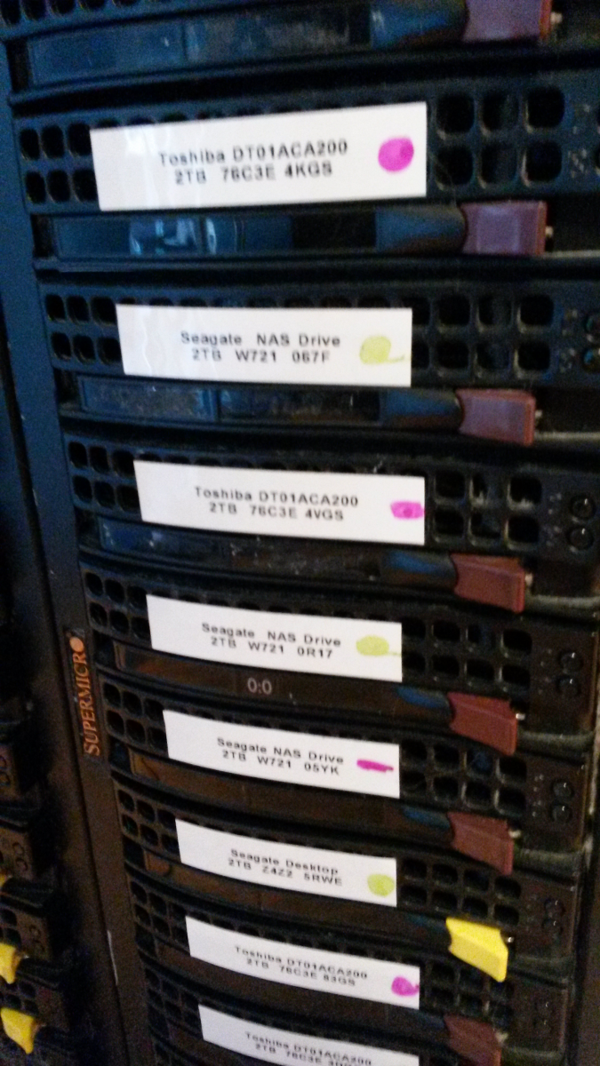

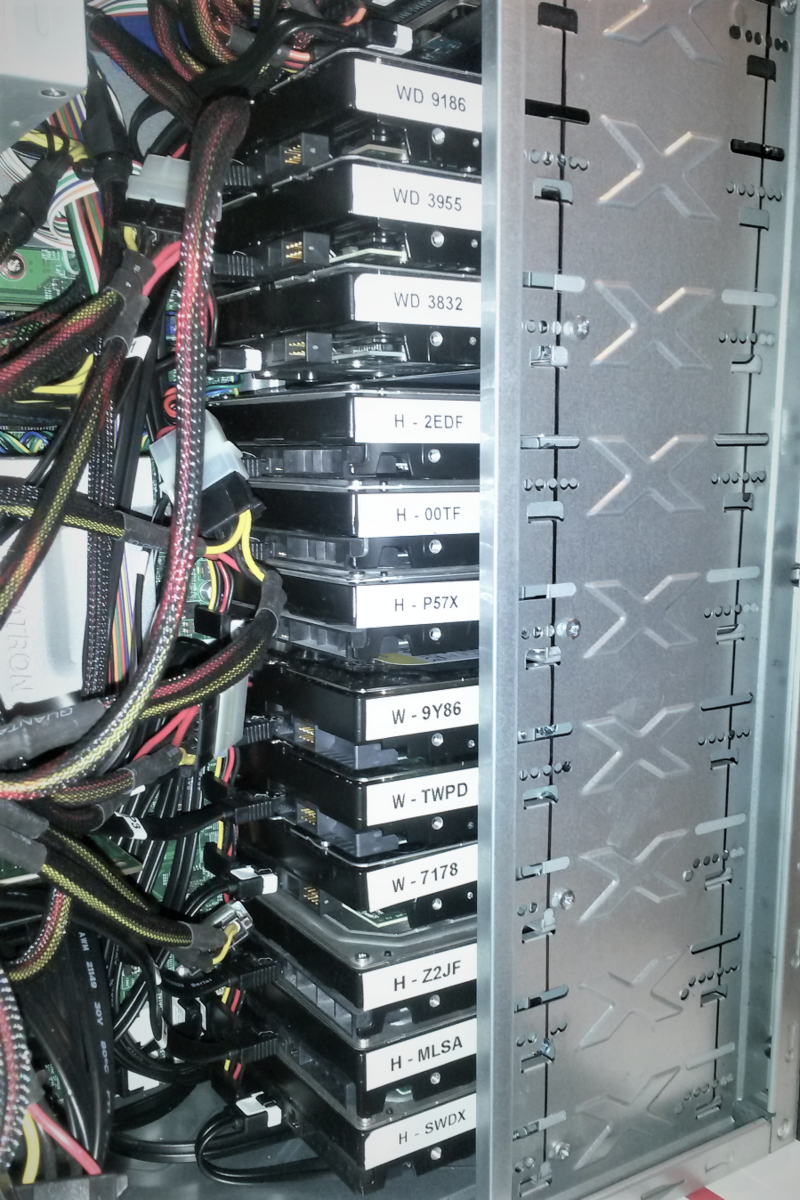

In one of the first FreeNAS systems I built, I put labels on the sides of the drives, so I could easily tell which drive was which, like this:

The serial number of the drive is the thing to go by when identifying drives. It will never change.
