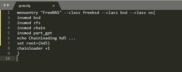

The bios.cfg was a typo its grub.cfg. I did the installation from Windows, and the bootloader worked with my windows + linux dual boot setup. After i tested the USB, i added the entry for FreeNAS, the cfg file looks like this:
Bios is set to AHCI, first bootable device is the usb, i saw FreeNAS in the grub menu, pressed enter and got the Chainloading hd5... Error: invalid signature. The SSD is on position 5 when the AHCI is loading.
Im sure i missed something with the cfg file. Or maybe there is something wrong with making a bootable device on Windows. :S
KrisBee
Mar 20, 2017
1,288
The config looks correct to me. But I suspect UEFI is in the mix if your GRUB USB drive can boot WIndows10 as AFAIK a BIOS-mode GRUB cannot boot an EFI-mode boot loader. Surely your microserver needs a BIOS-mode GRUB as I said above. If youl'e got a linux install why aren't you using that to create the USB boot drive you need? It should be straigh forward to do.
