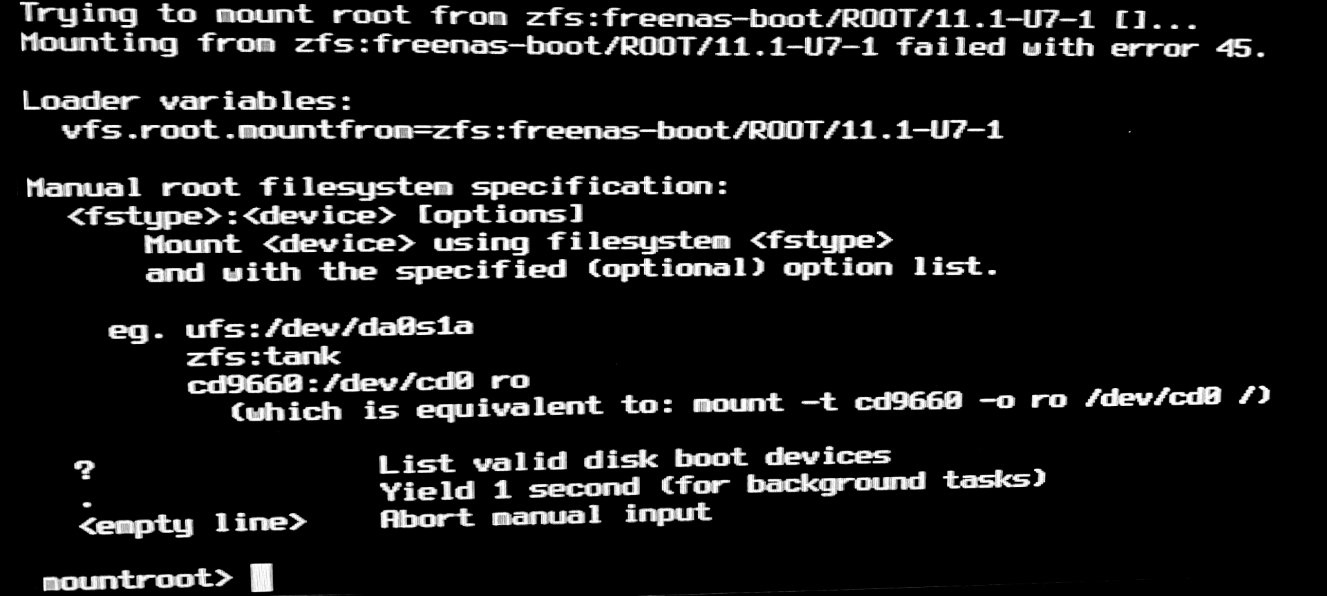

Mounting from zfs:freenas-boot/ROOT/11.1-U7-1 failed with error 45
Fnuxus
Apr 18, 2020
7

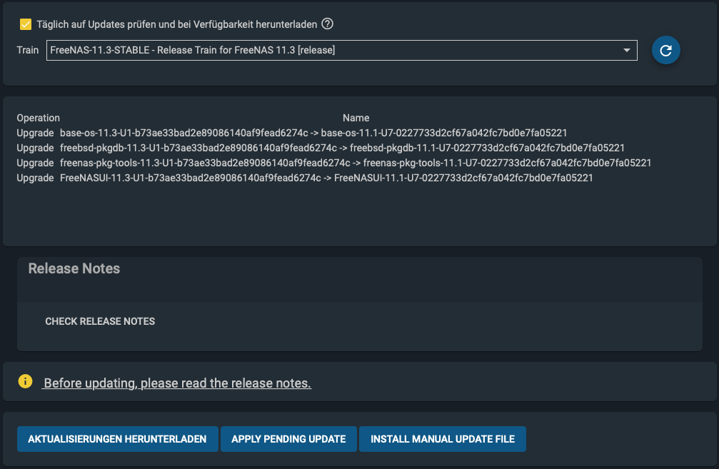

I run a freshly installed FreeNAS 11.3-U1 on a HP Proliant Microserver Gen8 with 16 GB of RAM and 4 x 4 TB harddisks configured as RAIDZ2 with an imported config file from an older version. I boot from a TrekStor i.Gear Prime 64 GB USB SSD drive.
The first update failed. :oops:
See attached screenshots. Any idea?

From the image your "upgrade" is actually a downgrade. 11.3 to 11.1 .
This is a bug but it helps if you are observant.
Try:
midclt call update.set_train FreeNAS-11.3-STABLE

I just tried updating to what I thought was going to be 11.3-U2.1 and got the same exact same error as FNUXUS. My system is very similar to his/hers and like him/her the attempted update was actually a downgrade - weird glitch! I am not a newbie, but perhaps just one level higher at this point. I would like to try the fix suggested by Alecmascot, but I do not know how. Where do I enter this code and how? I only have the “mountroot>” prompt or the “db> prompt”. I had been using 11.3-STABLE prior to the update attempt. Thanks.
Samuel Tai
Apr 24, 2020
5,399
Try to boot back into 11.3-U1, using the instructions in the Guide, section 2.5.5. Then once you're back in 11.3-U1, run that command from shell.

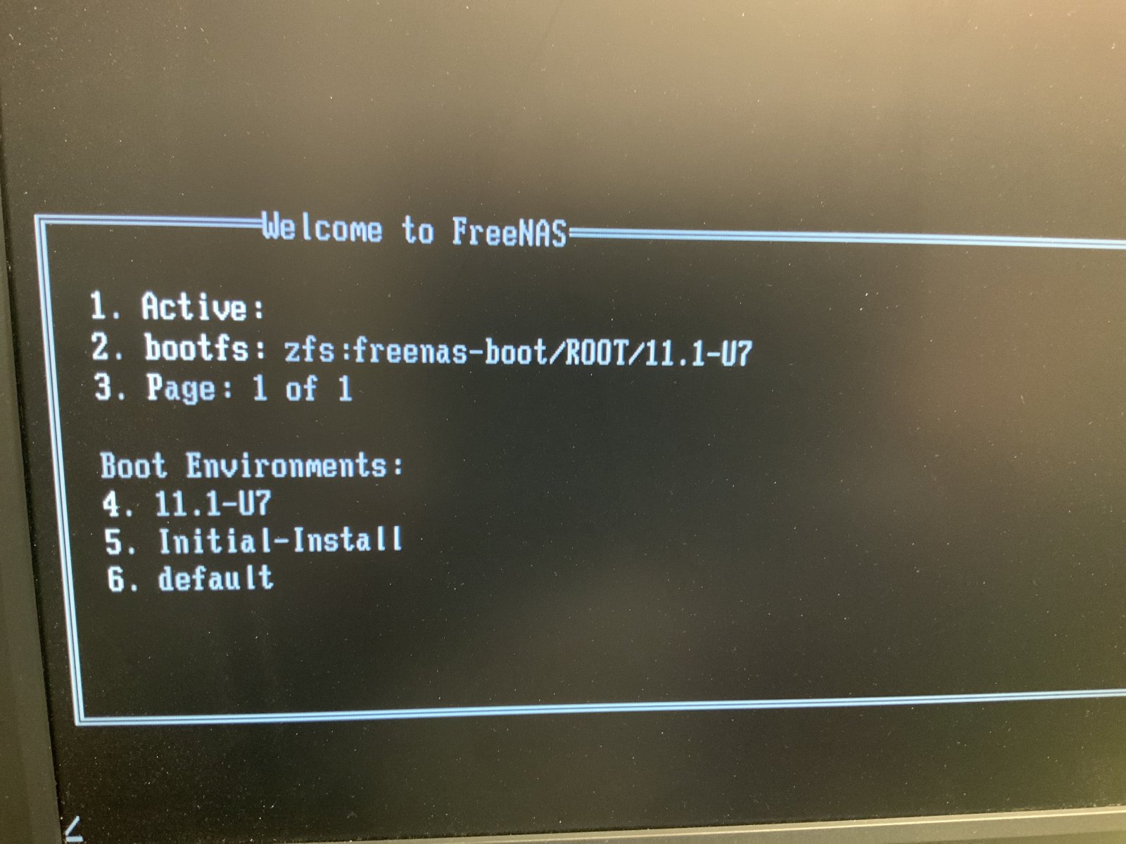

I had been using 11.3, but when I reboot the only boot environments listed are as shown in the attached photo? Not sure what happened to 11.3-U1? Which environment should I try to get to shell? Then I can try the suggested code.
Any other thoughts about how get out of this. I did save my last configuration prior to the update, but I do not know how to restore that with out the GUI?
Samuel Tai
Apr 24, 2020
5,399
You can try initial install, which will get you to the freshly-installed state and GUI. Then you can apply your saved config to get back to just before the upgrade attempt.

Also, default should be the environment before your upgrade attempt.

When you get back in, delete the non-working 11.1 boot environment.
