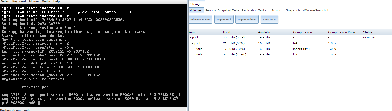

today our freenas stopped responding.
once we got a chance to look at it we noticed it looked like it was rebooted and sitting at
Importing Pool
txg 2796838 open pool version 5000; software version 5000/5; uts 9.3-RELEASE-p1
tsg 2796842 import pool version 5000; software version 5000/5; uts 9.3-RELEASE-p16 903000 amd64
its been at this state for over 3-4hrs
any idea if i should leave it sit here or what?
Supermicro server with 16 2TB drives
48G ram
dual cpu
mirror 240 SSD
single 320 SSD
LSI 9211
boots from usb stick
latest update release of 9.3 9.3-stable 201506292332
single pool
single vol
presented to a windows server via iscsi
attached is screen we are stuck on and storage config (not exact but very close, we have 2 of these set up)

nkrapf
Aug 22, 2014
28
i have not replaced usb yet, but i was able to boot to the original config profile.
there i ran zpool import and zpool status and it all looked ok.
from gui i did import vol, selected the vol and it went to step 2. how long would the second step usually take ?

Its stuck at the attached screen shot screen. So we should let it sit here till its done importing?
