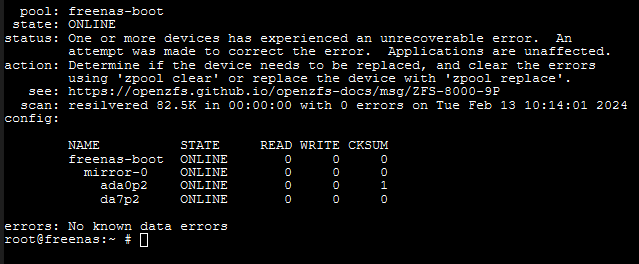

The boot drive on my TrueNAS CORE system is a couple of mirrored 40GB Intel SSD 320 series drives. I've recently got the following alert:
CRITICAL
Boot pool status is DEGRADED: One or more devices are faulted in response to persistent errors. Sufficient replicas exist for the pool to continue functioning in a degraded state.
See log below.
After a power down and messing with the SSDs I get the alert:
CRITICAL
Boot pool status is ONLINE: One or more devices has experienced an unrecoverable error. An attempt was made to correct the error. Applications are unaffected..
Few questions:
  1. How do I know what mirrored drive is bad?
  2. Can I pull one of the drives (assuming it still boots) and check if it's ada0, if so, put in the new and resilver? I'll probably then replace the other.
  3. Any suggestions on what SSD I should use as a replacement? On Newegg is see an Intel 40GB for $90 and a SanDisk 64GB for $30. I'll probably avoid the cheap Dogfish and Biwin drives. lol
Shown below is some of my log file and a few screenshots.

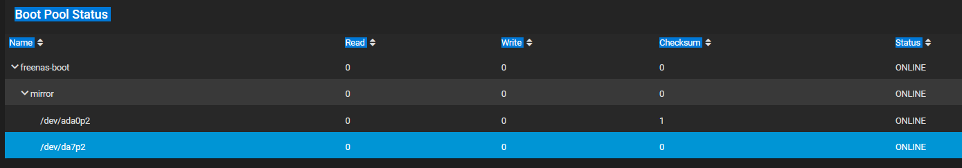

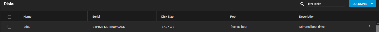

smartctl -a /dev/ada0 indicates the s/n is BTPR234301AN040G3 which is the drive listed in Storage / Disks (see screenshot above).
Do you agree the screenshot above shows ada0p2 and da7p2 as the mirrored SSD and ada0 is having checksum issues?
Going to the bottom of my list of drives is see the other drive:
Is there place in the GUI that shows the status of the mirror boot drives? I'm running TrueNAS CORE v12.0-U8.1.
System -> Boot -> Actions -> Boot Pool Status

From this screenshot it doesn't look like ada0 has completely failed, just checksum issues.
