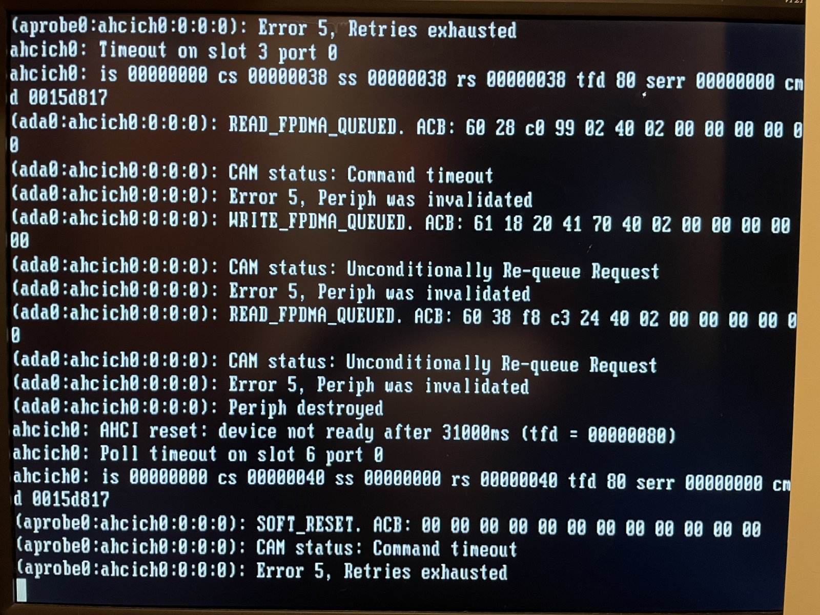

The server worked well for 6 months, but now it freezes (network connection drops and console seems unresponsive) 15-30 mins after it boots. I removed the NIC and the behavior is the same. I replaced the SATA interface card and still the same.
I took a picture of the frozen server screen. The picture is attached. The bellow is an OCR
(aprobe0:ahcich0:0:0:0): Error 5, Retries exhausted
hcich0: Timeout on slot 3 port 0
hcich0: is 00000000 cs 00000038 ss 00000038 rs 00080038 tfd 80 serr 00000000 cmd 0015d817
(ada0:ahcich0:0:0:0): HEAD FPDNA -QUEUED. ACB: 60 28 c0 99 02 40 02 00 00 00 00 00
(ada0:ahcich0:0:0:0): CAH status: Command timeout
(ada0:ahcich0:0:0:0): Error 5, Periph was invalidated
(ada0:ahcich0:0:0:0): MHITE_FPDNA_QUEUED. ACB: 61 18 20 41 70 40 02 00 00 00 08 10
(ada0:ahcich0:0:0:0): CAN status: Unconditionally He-queue Request
(ada0:ahcich0:0:0:0): HEAD_FPDNA_QUEUED. ACB: 60 38 f8 c3 24 40 02 00 00 00 00 0
(ada0:ahcich0:0:0:0): CAN status: Unconditionally Re-queue Request
(ada0:ahcich0:0:0:0): Periph destroyed
ahcich0: AHCI reset: device not ready after 31000s (tfd = 00000080)
ahcich0: Poll timeout on slot 6 port 0
ahcich0: is 00000000 cs 00000040 ss 00000000 rs 00000040 tfd 80 serr 00000800 cmd 0015d817
(aprobe0:ahcicl10:0:0:0): SOFT_HESET, ACB: 00 00 00 00 00 00 00 00 00 00 00 08
(aprobe0:ahcich0:0:0:0): CAN status: Command timeout
I'm thinking of moving it to a new server (keeping the same NIC and drives), but before I start chasing my tail on that I wanted another opinion.
Thanks!!

FYI, seems to have been cables/connectors getting loose. Upgraded to v12 and in the process I exported all pools so that I could disconnect all data drives and make sure I was installing it in the right drive. After the upgrade and reconnecting the drives the error seems to have gone away.
Phase
Sep 30, 2020
63
Issue was with the boot pool. Changed controller to an LSI one and the boot SSD was no longer recognized. Replacing that pool and trying again tomorrow, when I get the new SSDs.
