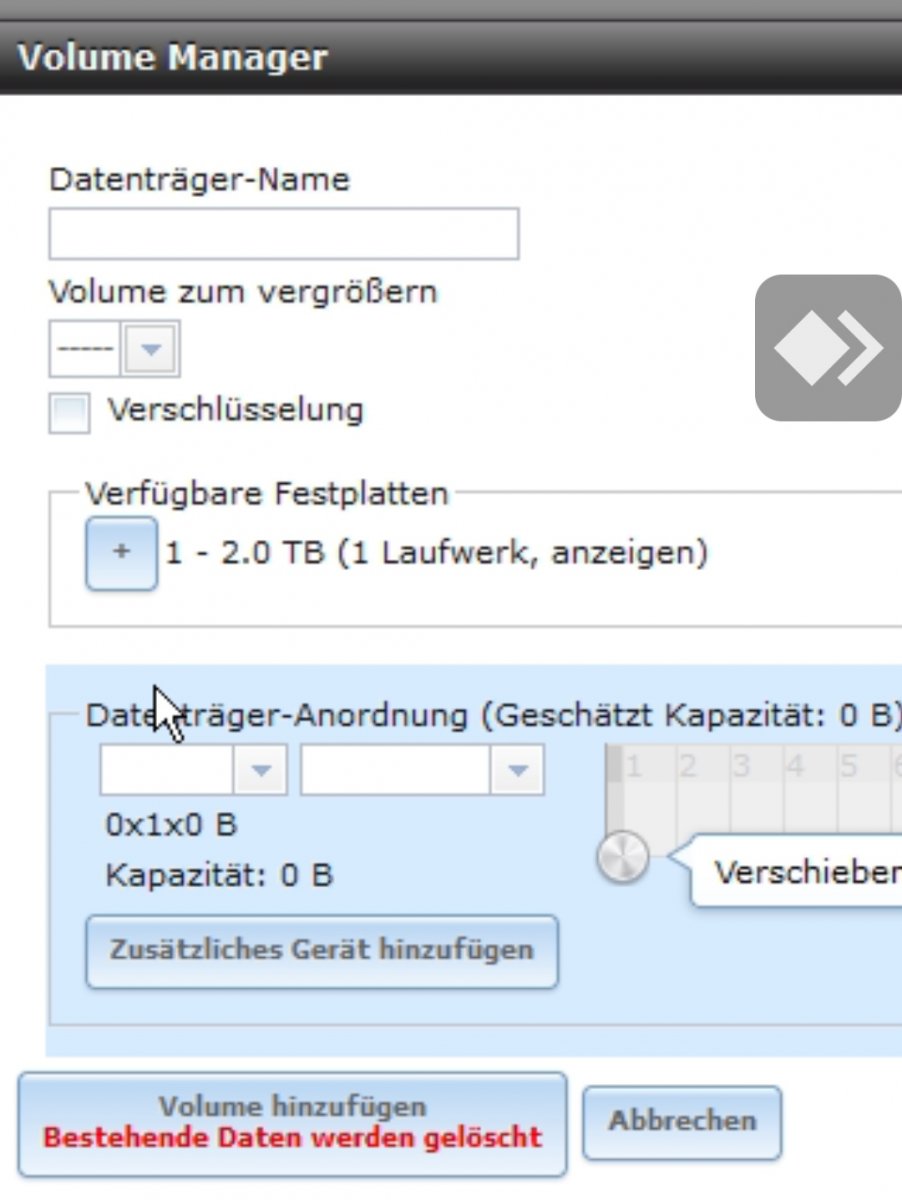

As docu tells i should use volume Manager..but volume Manager tells me i could add a 2tb disk... The size of the new and old disks..
I assume i have to add the replaced disk Here to the Pool. Should i give Name ada0 here? Other things to do? And perform? Data ist still available through Explorer share ..

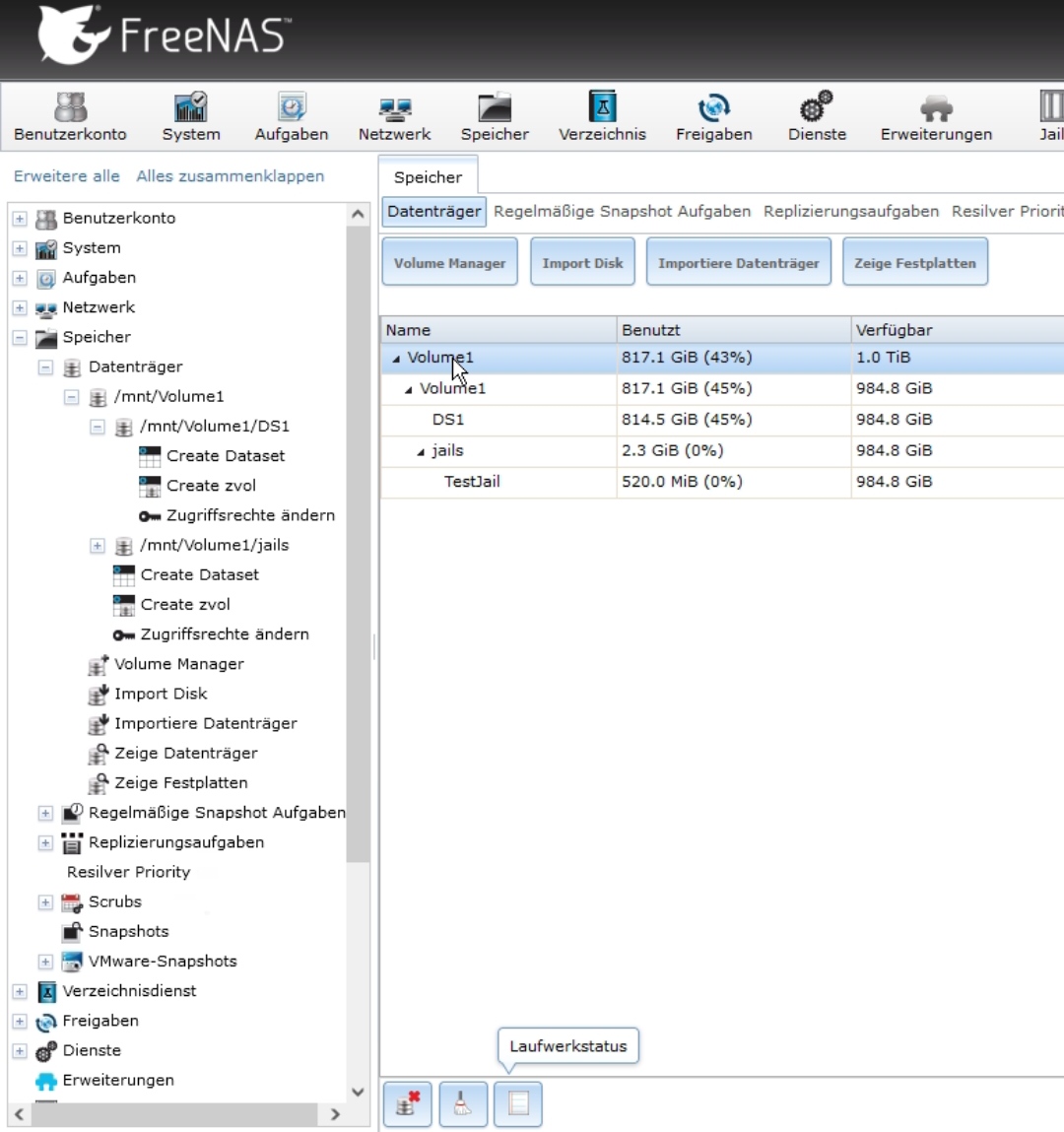

Before physically removing the failed device, go to Storage ‣ Volumes. Select the volume name. At the bottom of the interface are several icons, one of which is Volume Status. Click the Volume Status icon and locate the failed disk. Then perform these steps:...
Or should i perform Import.. In Datenträger?
I do not finden storage.Volumes... Only storage volume Manager.. . Zeige Datenträger.. Zeige Festplatten..

What ist the difference between Import disk and add a disk in volume Manager (to Pool)?
There's no difference in the sense that you don't want to do either of those things right now.

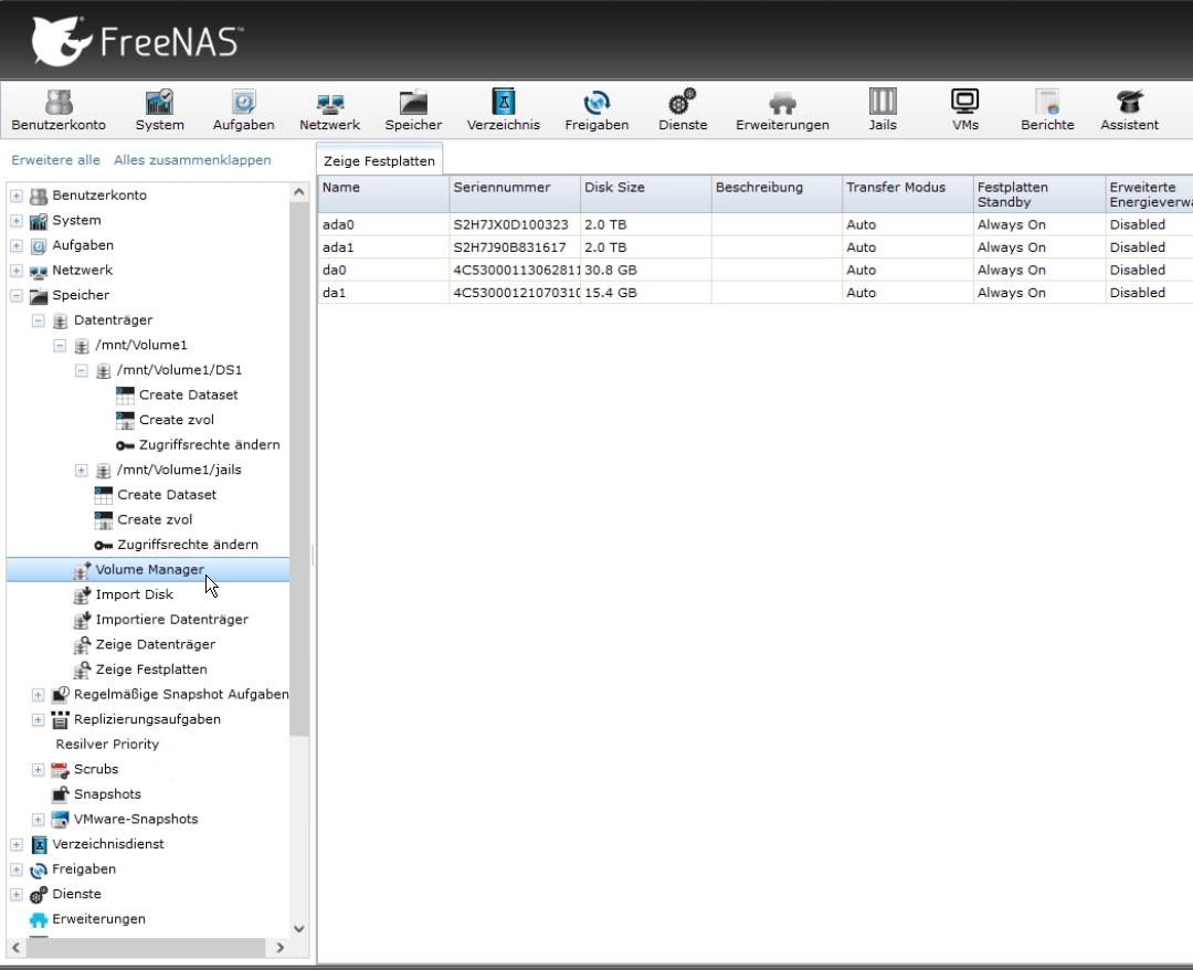

9,700
If you're using Windows... use the Prt Scrn button and then CTRL + V in the window or use the clipping tool and paste it in as you're typing.
9,700
I do not find the Tab volume status..
bernd67
Jan 7, 2017
88
Hope Attachments included now
bernd67
Jan 7, 2017
88

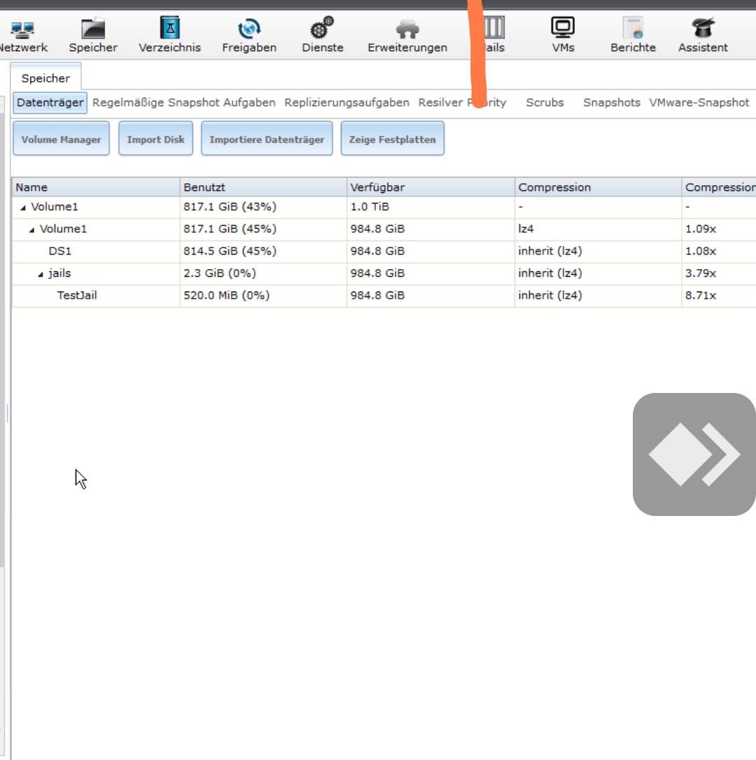

Next Screenshot to your Question. Thank you!
Now I found the Attach File Button here..

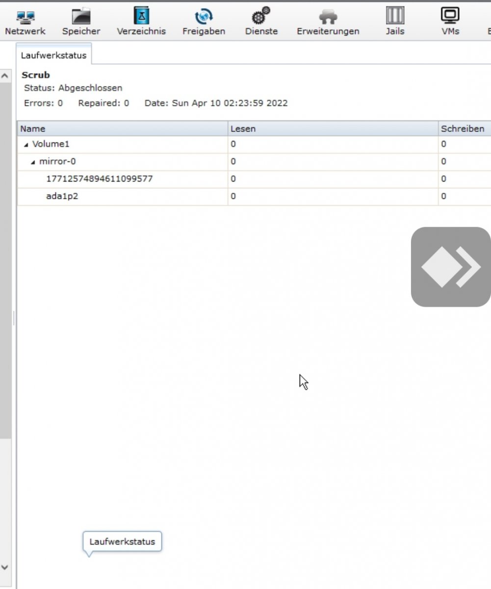

bernd67
Jan 7, 2017
88
I hope a better over view now..
I die not realize the small Icons before..
What to do next?
bernd67
Jan 7, 2017
88

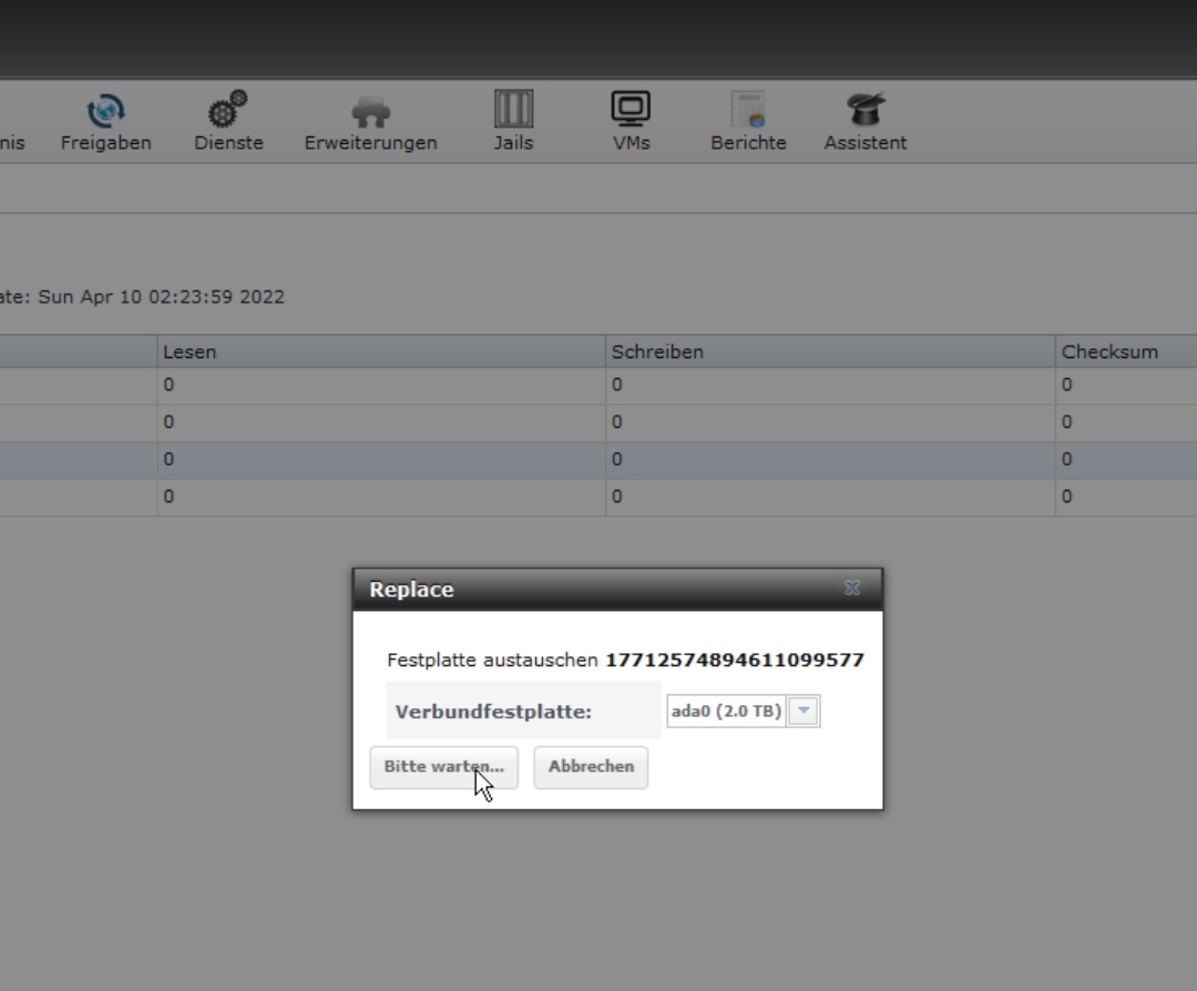

Should I use the small Button "replace"...... In volume 1 mirror 0 and on the numner 177..9577?? ? Ada1p2 I hope the other one ist hopefully still Containing my data..?
bernd67
Jan 7, 2017
88

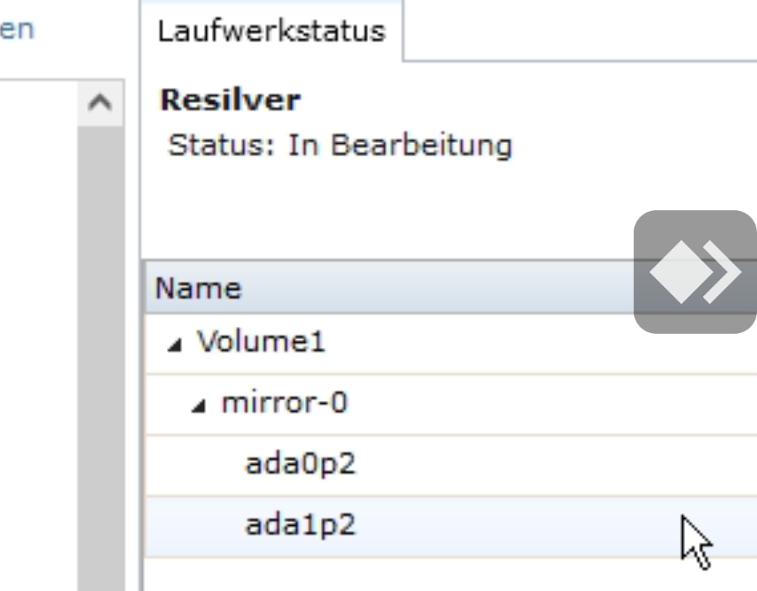

New status is.. After press Button replace
Re silver running!
bernd67
Jan 7, 2017
88
Mail..
volume Volume1 state is ONLINE: One or more devices is currently being resilvered. The pool will continue to function, possibly in a degraded state.
.. Progress 94 percent..
