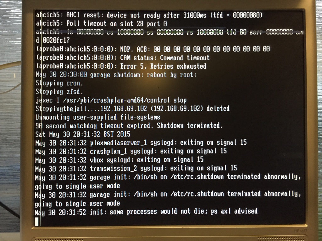

5) If I reboot on the command line (shutdown -r now) it fails to restart.... which is problematic as I was away on holiday when this first happened!
On the console the error messages seem to indicate something is preventing reboot (see photo of console below)

May 31 16:11:44 garage (ada2:ahcich5:0:0:0): Error 5, Periph was invalidated
May 31 16:11:44 garage zfsd: Event exceeds event size limit of 8192 bytes.
May 31 16:11:44 garage zfsd: Truncated 9 characters from event.
May 31 16:11:44 garage GEOM_ELI: g_eli_read_done() failed ada2p1.eli[READ(offset=11010048, length=61440)]
May 31 16:11:44 garage swap_pager: I/O error - pagein failed; blkno 1051266,size 61440, error 6
May 31 16:11:44 garage vm_fault: pager read error, pid 2565 (python2.7)
May 31 16:11:44 garage kernel: pid 2565 (python2.7), uid 0: exited on signal 11
May 31 16:11:46 garage swap_pager: indefinite wait buffer: bufobj: 0, blkno: 1049934, size: 12288
May 31 16:12:06 garage swap_pager: indefinite wait buffer: bufobj: 0, blkno: 1049934, size: 12288
May 31 16:12:33 garage ahcich5: AHCI reset: device not ready after 31000ms (tfd = 00000080)
May 31 16:12:33 garage ahcich5: Poll timeout on slot 23 port 0
May 31 16:12:33 garage ahcich5: is 00000000 cs 00800000 ss 00000000 rs 00800000 tfd 00 serr 00000000 cmd 0020f717
May 31 16:12:33 garage (aprobe0:ahcich5:0:0:0): NOP. ACB: 00 00 00 00 00 00 00 00 00 00 00 00
May 31 16:12:33 garage (aprobe0:ahcich5:0:0:0): CAM status: Command timeout
May 31 16:12:33 garage (aprobe0:ahcich5:0:0:0): Error 5, Retries exhausted
May 31 16:12:33 garage swap_pager: indefinite wait buffer: bufobj: 0, blkno: 1049934, size: 12288
May 31 16:12:53 garage swap_pager: indefinite wait buffer: bufobj: 0, blkno: 1049934, size: 12288
May 31 16:13:03 garage ahcich5: Timeout on slot 23 port 0
May 31 16:13:03 garage ahcich5: is 00000000 cs 00800000 ss 00000000 rs 00800000 tfd 00 serr 00000000 cmd 0020f717
May 31 16:13:03 garage (ada2:ahcich5:0:0:0): READ_DMA. ACB: c8 00 e0 2a 00 40 00 00 00 00 18 00
May 31 16:13:03 garage (ada2:ahcich5:0:0:0): CAM status: Command timeout
May 31 16:13:03 garage (ada2:ahcich5:0:0:0): Error 5, Periph was invalidated
May 31 16:13:03 garage GEOM_ELI: g_eli_read_done() failed ada2p1.eli[READ(offset=5554176, length=12288)]
May 31 16:13:03 garage swap_pager: I/O error - pagein failed; blkno 1049934,size 12288, error 5
May 31 16:13:03 garage vm_fault: pager read error, pid 2560 (python2.7)
May 31 16:13:03 garage GEOM_ELI: Device ada2p1.eli destroyed.
May 31 16:13:03 garage GEOM_ELI: Detached ada2p1.eli on last close.
May 31 16:13:03 garage (ada2:ahcich5:0:0:0): Periph destroyed
May 31 16:13:03 garage swap_pager: I/O error - pagein failed; blkno 1051458,size 32768, error 6
May 31 16:13:03 garage kernel: Failed to write core file for process python2.7 (error 14)
May 31 16:13:03 garage kernel: pid 2560 (python2.7), uid 0: exited on signal 11
May 31 16:13:52 garage ahcich5: AHCI reset: device not ready after 31000ms (tfd = 00000080)
May 31 16:13:52 garage ahcich5: Poll timeout on slot 23 port 0
May 31 16:13:52 garage ahcich5: is 00000000 cs 00800000 ss 00000000 rs 00800000 tfd 00 serr 00000000 cmd 0020f717
May 31 16:13:52 garage (aprobe0:ahcich5:0:0:0): NOP. ACB: 00 00 00 00 00 00 00 00 00 00 00 00
May 31 16:13:52 garage (aprobe0:ahcich5:0:0:0): CAM status: Command timeout
May 31 16:13:52 garage (aprobe0:ahcich5:0:0:0): Error 5, Retries exhausted
I have replicated the volume off the SSD to the spinning disks mirror without any errors. A scrub of the SSD reveals no errors. I can successfully run the VirtualBox image off the spinning disks without problems.
If this was off a single spinning disk I would say that the problem was a failing disc and the system lockup was because some of the virtual memory is on the failing disk?? But this is an SSD and is highly unlikely to fail? It also seems to work absolutely fine copying 20gb of information off it no problems (but I guess not writing to it).
Does anyone have any suggestions?
Should the failure of a non-system disk cause such erratic and unstable behaviour? Can I stop a particular disk being used for virtual memory?
  1. The error from FreeNAS was pretty unequivocal, i.e. that it has a problem with ada2. The precise root of that problem is unclear to me (drive, cable, port?)
  2. Before attempting to run multiple plugins, including resource hogs like Plex, CrashPlan and VirtualBox, install more than the minimum 8GB of RAM.

I feel like I remember this guy from IRC. If it's the same guy, he says he's replaced both the drives, and the cables, for ada2, and no matter what drives he puts in there, it craps out with this error about ada2.
Forgive me if it's not the same guy.
John Gorst
Dec 18, 2014
15
Seems to be sorted after changing cables........ very odd! You wouldn't think that increasing the load would cause the cable to fail!
Robert Trevellyan
Pony Wrangler
May 16, 2014
3,778
Why not? I would think elevated temperature resulting from increased load could easily result in worse behavior from marginal components.
