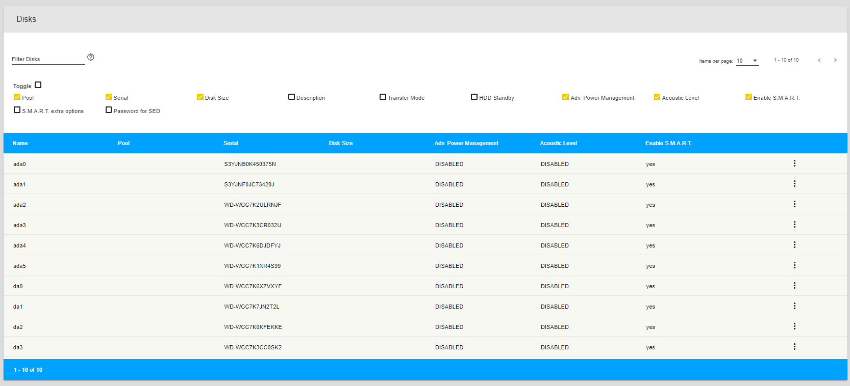

after the whole operation I have issue with pools
there is new drive called ada1: S3YJNF0JC73420J
Previously I had only ada to 4, but now there is ada to 5
is there any way to fix it?

What do you want to fix? That's your (new) boot drive.

I know that this is new drive for boot, but how to fix pool vol1?
How to rearange the id for disks?
What for? EDIT: I doubt it would help...
Usually these names may change and one should not rely on them.
Pools are usually built using gptids and it's done somewhat automatically...
So some other way of fixing is needed...

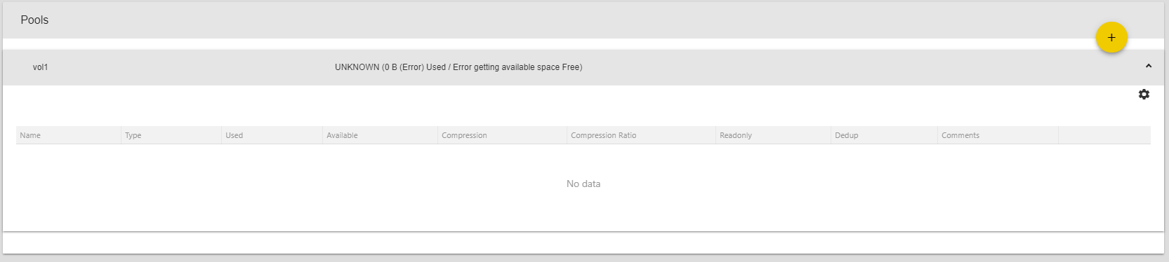

Now I have no access to my data vol1 is not accessible

I doubt rearranging would help. Some other way should be checked first. Maybe someone more experienced will chime in...

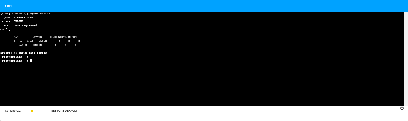

Update: you can start with posting results of zpool status command in code tags.

You can't - that naming is assigned by the system.
is it possible to add disks to pool once more and to not lost data in the disks/pool? I do not know how to call this operation - reindex/restart the pool?
Reseting cables on the mainboard can help?
15,504
Yes, under certain circumstances. The manual will tell you more.
As to your problem importing the pool, it seems strange. What's the output of zpool import?
