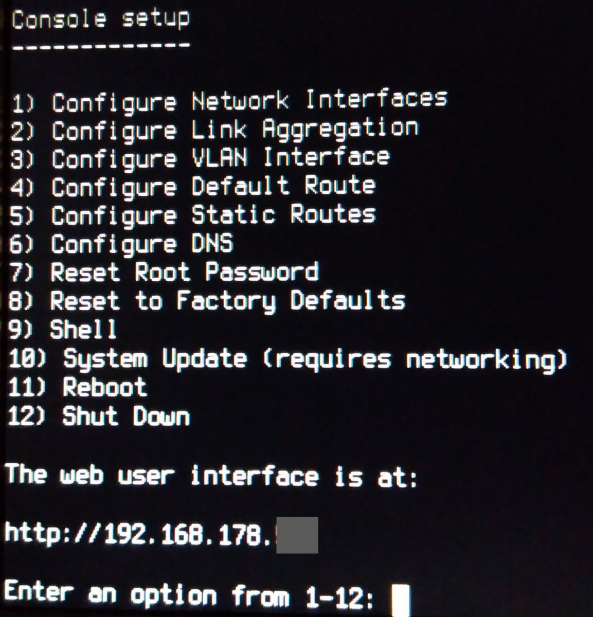

  • 09:50: Boot finished as I see the console menu:
