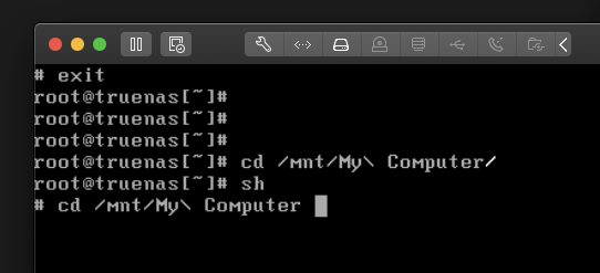

I have noticed that when using the default shell /bin/sh when user is created I cannot do this for example
using the tab to complete, it adds a space to the end
For example:
The problem from this that I cannot copy/move anything using the TAB, the shell doesn't find it
For Example:
Is this a know issue?
this happens with every folder with spaces in the name (and I dont have a space at the end go the name)
I didn't notices that I use /bin/sh since I always use csh which is working fine and this issue is not there
Thanks

I am on TrueNAS-12.0-STABLE but dont think the /bin/sh is different
-r-xr-xr-x 1 root wheel 161368 Dec 7 23:44 /bin/sh
are you sure you are on /bin/sh and not other shell?

The issue is only on the TrueNAS , when using /bin/sh inside a jail where /bin/sh is newer the issue is not there
9,700
OK, so apparently I was in the new default zsh.
In sh, I get the trailing space, but can get tab completes.

Its possible to tab for completion (assuming you see additional space) , the problem is not the chdir , its coping/moving to this location with or without tab
9,700
I note that in the screenshot example you gave for cp, you have a syntax error.
you tried ... The\ Boys \Se <TAB>
Instead of ... The\ Boys\ Se <TAB>

No, that's the TAB that completes, I didn't type it
try to copy a file and see (when /bin/sh)

strange , I just installed under fusion and the same issue out of the box (this is with tab completion)
doesn't matter I anyway don't use /bin/sh
