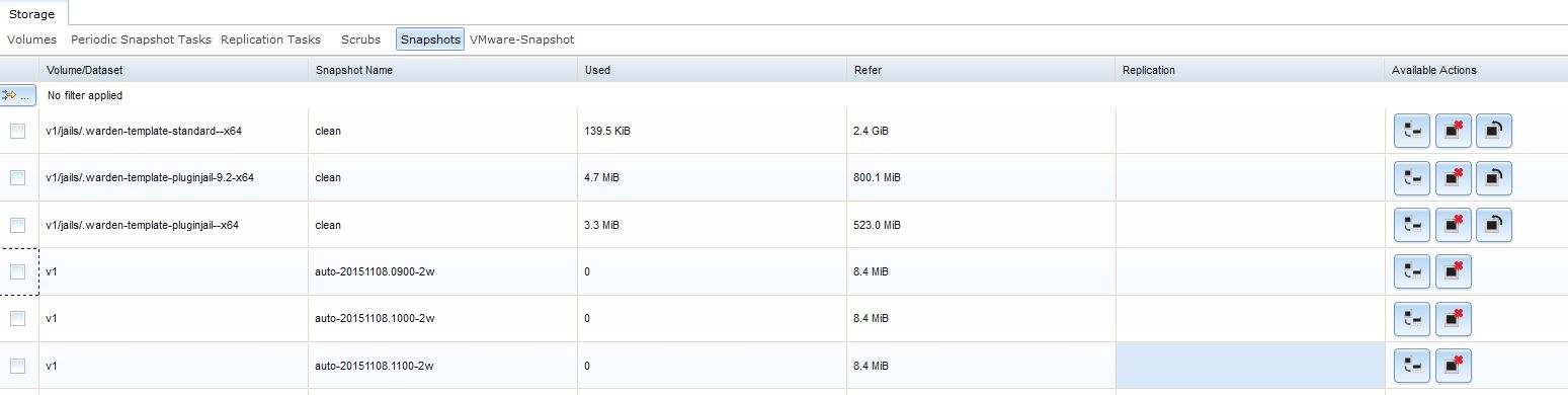

Backup failed!
Reason: Cannot authenticate
Hostname or IP address - I presume this is the IP address of my freenas
User name and PW - the username and PW for my freenas login
Remote directory - where I want to put the backup on my remote computer in the form \\computername\backupfnas
I setup the backupfnas directory to have a share of guest on my Win7 machine
I don't see an option for replicate in the snapshot tab

depasseg
FreeNAS Replicant
Sep 16, 2014
2,874
Aha! thanks Robert. I missed that little nugget buried in the instruction paragraph.
BigB - It's expecting an SSH host, not a windows share.
And look at the screenshot you pasted. The "Replication Tasks" is a separate tab (next to "Snapshots")
Snapshot and replication are on two different tabs.
