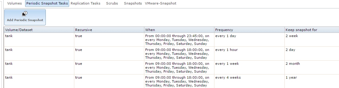

  1. Could you clarify the "Recursive Snapshot" ? As I understand it : It applies to the specified dataset and the nested datasets. Is that right ?
  2. Would you recommend to always take "Recursive Snapshop" in case of future sub-datasets creation.
  3. What is your typical periodic snapshot plan for backup ? : Lifetime, Interval
  4. Begin, End : Snapshots are more useful when data is supposed to change. So I suppose, Begin and End should match working hours ?
  5. How do you typically manage stale snapshots : delete selected in the replication task or manually ?
  6. How to configure Begin and End of replication : Is it better after working hours ? Or it can be done all day ?
So a snapshot of a dataset, without the recursive option, will only create a snapshot of the data that exists in that dataset, but not the subdatasets. If you wanted snapshots of sub-datasets, you would need to create those separately, or alternatively, use the recursive option. Recursive works if you are happy having the main and sub datasets on the same schedules.
I do it that way for my setup, but that is because I'm fine with all the snapshots being taken at the same time, and they don't need to be different frequencies.
The only reason I see to limit the hours, is to limit the number of snapshots. Some I have set for business hours, others go all day.
That is the "keep snapshots for" column shown above.
I let mine run all the time. It will only run when there is a snapshot and the overhead isn't too much for my server or switches. If it became an issue, I'd restrict it to a slow time frame.
What if replication occurs when scrub is made ? Any scheduling issue there ?
I haven't noticed anything. I guess there could be an issue, but my scrubs are middle of a weekend slow period, so any snapshots to be replicated should be small and quick.

Thanks a lot for this very clear answer.
I meant : do you check the box "Delete slate snapshots on the remote system" ?
depasseg
FreeNAS Replicant
Sep 16, 2014
2,874
Ahh, yes, I use the delete stale snapshots option. If you didn't use that, then you would need to delete manually. Or just watch your pool completely fill up and go boom.
