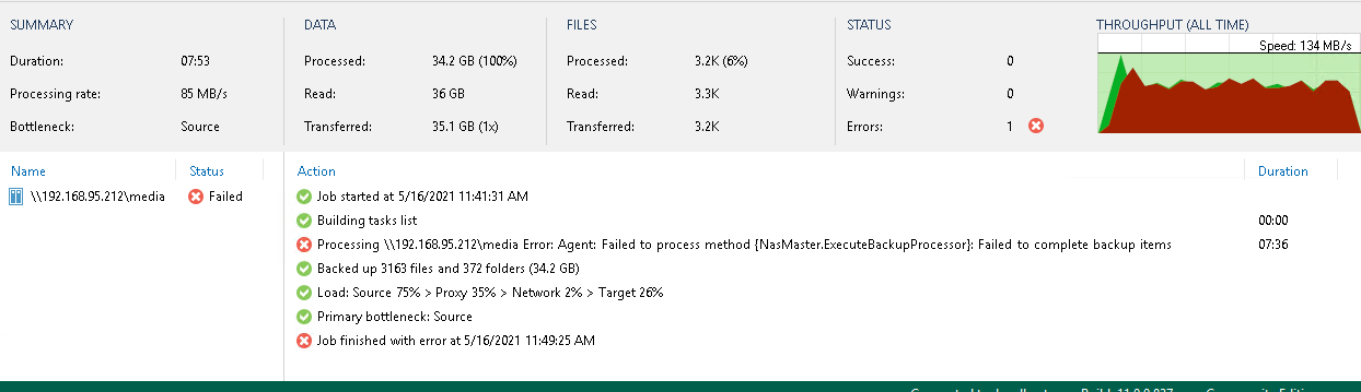

Been running TrueNAS 12, no problems, zPool and vDevs working as expected, so does the HBA, I am experiencing an issue trying to backup the actual SMB share on TNAS using Veeam Backup and Replication, so Veeam connects to the SMB share and starts backing up from TNAS to another NAS and eventually reports an error. I'm not saying the issue is TrueNAS but there is a few options when backing up and I was wondering if option 1 should be the one to use. I don't option 2 and 3 will apply
This is the error reported by Veeam
Error: Agent: Failed to process method {NasMaster.ExecuteBackupProcessor}: Failed to complete backup items

I am having the same issue. We're using Veeam file backup to backup a TrueNAS 12 share and are receiving the same error. Were you able to find an answer?

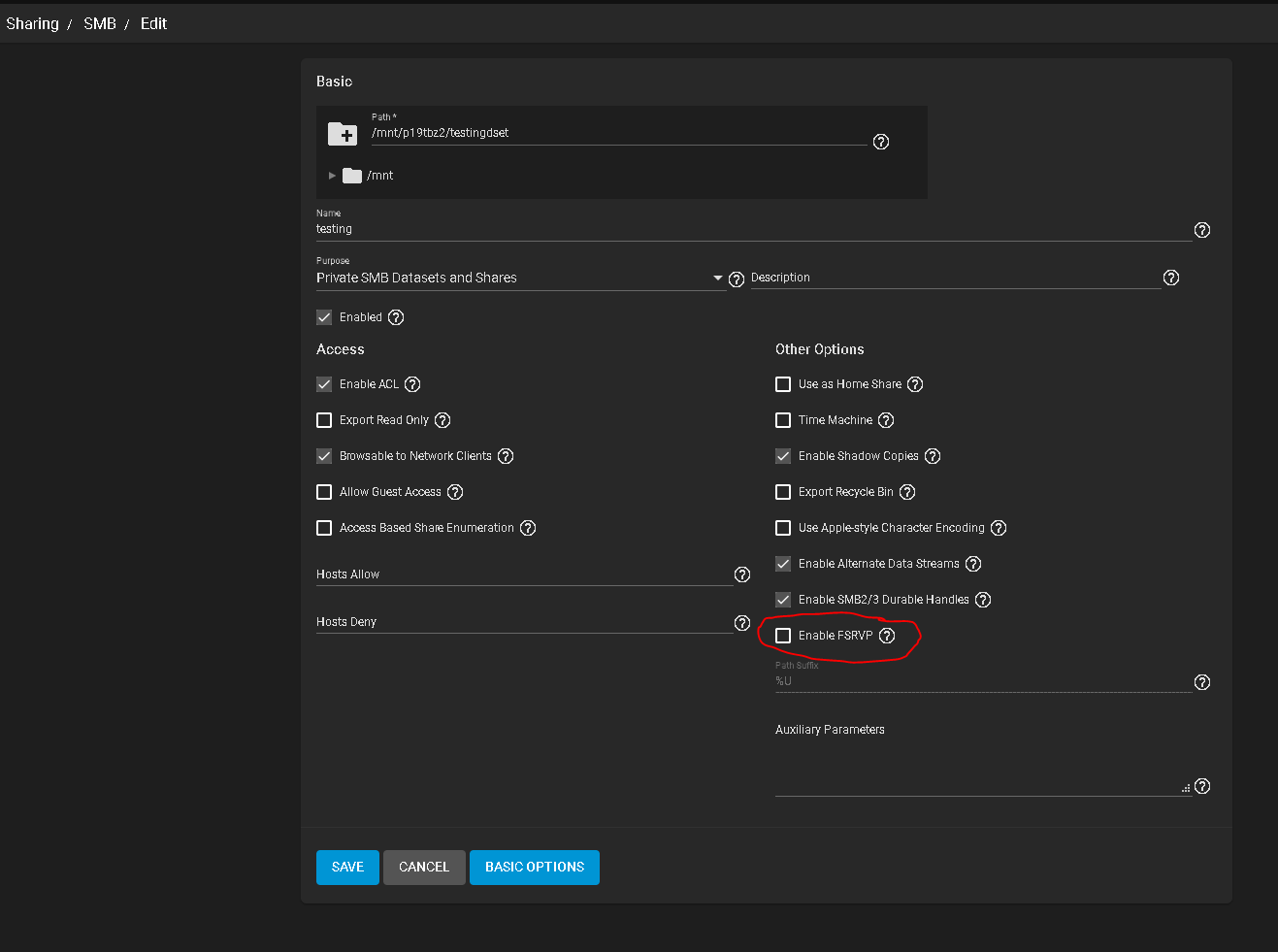

If you ticked the option Enable Shadow Copies on the share, option 2 may work.

I found this on the SMB shares options, I'm not sure but it could be possible the FSRVP option would help
Need to read more about it

Apparently the FSRVP is for something else not exactly the Veeam backup process.
I updated TrueNAS to the U3 version yesterday, ran another backup today
I monitored the resources on the TNas server and CPU goes up to max 7% but Veeam reports source bottlenecks, it reads a few gigabytes though before failing, I don't know if Veeam will be able to fix this, I seen reports over the years with their software malfunctioning when the source appliance is not a true Windows VSS box or VMWare one, they had the same issue with some Equalogic's and I guess TrueNAS is not different in this aspect

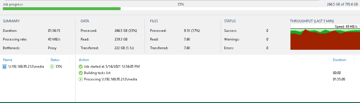

@greenieofdub I'm doing some testing, I have a suspicion TrueNAS is not the bottleneck as pointed out by Veeam, those are just numbers which doesn't take in consideration other parameters, in my specific case seems TrueNAS and Veeam are "too fast" for the infrastructure repository, a RAID5 Thecus. I'm manually adjusting parameters within the specific backup task to limit the throughput to something "manageable" by the Thecus and Veeam interaction. Managed to keep the throughput instead at 134 Mbps to a 61 Mbps, still failed.
I reduced now the concurrent tasks on the storage to 1 and limited the speed of the infrastructure object to 50 Mbps I think. Already surpassing previous numbers but it could fail at any point.
Now the bottleneck is the destination storage but limiting such will balance the entire process, how the Proxy which is the buffering process handles this I don't know, we will see it if runs properly. Will provide an update later on
zbyte
Member
Jan 3, 2021
31
Still far from finishing but from 2 - 3 % completed I'm at 33% percent looking good
The bottlenecks seems to be the destination, TrueNAS and Veeam are fast enough to process. Just limiting the concurrent sessions and speed to the destination infrastructure seems to have fixed the problem.
