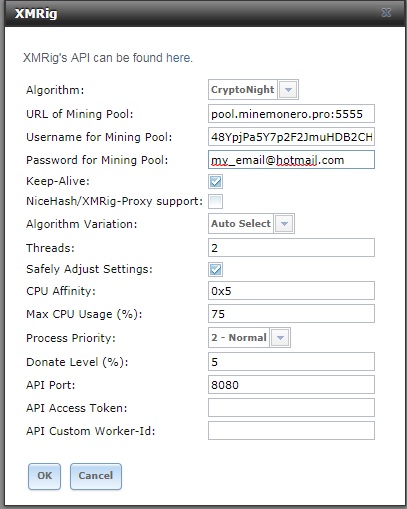

ok, so it seems I'm the only person here having troubles with the plugin...
after downloading it and setting the plugin as reported, it doesn't start at all...
where am I wrong???

May i just ask you what the "donate level %" is and what does it happen if i modify it?
Inviato dal mio LG-D855 utilizzando Tapatalk
Joshua Parker Ruehlig
Dec 5, 2011
5,949
that is how much of your hashing time (1-99%) is donated to the devs. you can lower it to 1, just don't set it to 0 or it will reset to the default of 5.

Can't login to
https://monero.hashvault.pro/en/#!/
It says invalid password...
I put my wallet public address set on the plugin and as password the "Password for mining pool" (myemail@hotmail.com)set in the xmrig plugin tab.
Where am I wrong?

Yes, seems to be mining, even if it reports in the graphs just a 25% cpu usage (with an i3 I put 0x5, 4 threads,100%cpu usage).(is that normal? Is it set as the max i can mine?)
You put
freenas:myemail@hotmail.com
On the FN plugin tab or as password oh the website?
Dec 5, 2011
5,949
You put
i put that in the freenas settings. on the website i used my email, then after my first login i changed the password to something else
as for your cpu usage, if you enabled "safe" even if you specify 4 threads xmrig may lower it to what it thinks is optimal for the processor.
i think for an i3 i would put '0x5' for affinity as you did, and just try 2 threads. i3's only have 3MB cache so i think more threads won't help.
