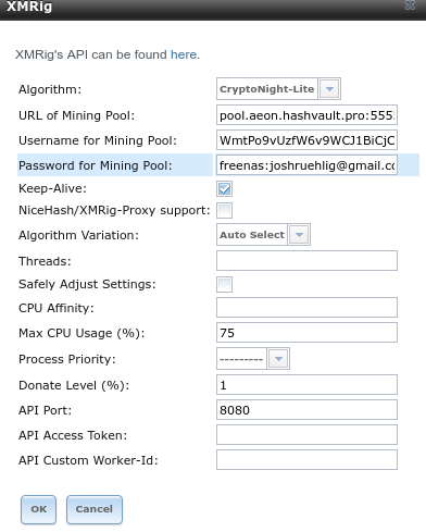

I got an update built "2.4.3_1" should be available from the FreeNAS repo in the next day or so. I added several relevant options (see attached).
