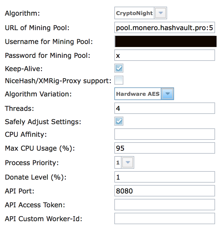

Hi all. Ideas much appreciated. Trying to use the plugin to connect to an Aeon mining pool, but it seems not to want to connect, or at least aeonminingpool is not seeing my server. From the jail terminal, I can ping aeonminingpool.com
I have an Aeon Wallet string as the username
I have my email as the password
I can ping the pool.
The dashboard on aeonminingpool.com does not see any hashes from me
Ideas? am I missing something simple?
Two images
https://ibb.co/eWyWcn
eWyWcn
https://ibb.co/mvY3q7
Cheers
b.

Did you change your Algorithm to CryptoNight-Light?
billgreenwood
Apr 11, 2014
42
Yes I did. I'm just scratching my head here. I've tried passing the whole IP through a VPN in case it was blocked by an ISP. I've port forwarded the port to the Server internal IP. I'm stumped to be honest.

Different pool can take a while to show your hashes. It looks like from your API that you are hashing at 419H/s
billgreenwood
Apr 11, 2014
42
I set up Monero on another box and this worked a dream. I'll leave this running all night and see the state of play in the morning. The API looks ok. AFAIK. Well as far as I can see! Not sure if 419H/s is decent for Aeon.
