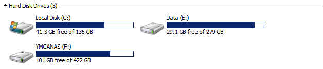

It looks that way but it isn't actually showing up on the iSCSI mount that I have on the Server.
EDIT: YMCANAS is the iSCSI

Hmm... iSCSI eh... Have you restarted the iSCSI service?

Not thinking that is needed. However, I am not an iSCSI guru; so others may provide better insight. I am keeping steps simple... So how about on the client end? Have you either rebooted there or restarted the service (may have as well since you mentioned power issues...)?

The picture attached show what I would see as a ZFS structure but without any zvols. If I am correct. As the volume shows only 511GB available without any expansion available. If I am wrong please correct me :)
