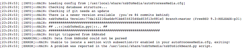

Somehow the script was no longer in my transmission settings. I re-added script to transmission and updated all settings according to blog. Here is an error log I get from Sab. FreeNAS UI says there are no updates for Sab. Any thoughts on this?
looks like your autoProcessMedia.cfg isn't setup properly.
the update it's referring to is for nzbtomedia, you can update that by doing a 'git pull' in its directory.

the error said you were missing a tv section. I'd check that
cd /usr/local/share/nzbToMedia
git pull
chown -R media:media *

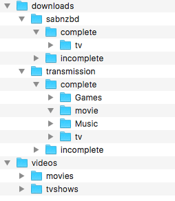

Can you please clarify what you're referring to specifically? Are you saying there is a section named TV in the autoProcessMedia.cfg file or are you saying I'm missing the tv section path in the Transmission section of the autoProcessMedia.cfg? I do have the folders in my dataset.
