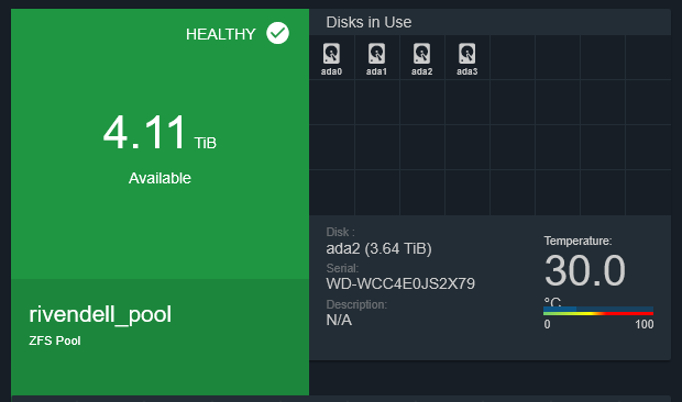

The reason why I am stumped is because on the dashboard it looks like
9,703
The dashboard won't show a problem until a disk actually fails or causes data loss... your pool is actually healthy because ZFS and low-level disk functions have saved you so far.
SMART tests are there to warn you before failures cause real problems with your data.
You probably shouldn't be running short tests every 2 hours... once a day is enough. Maybe that's why your long tests fail as they can't finish before another short test starts?
