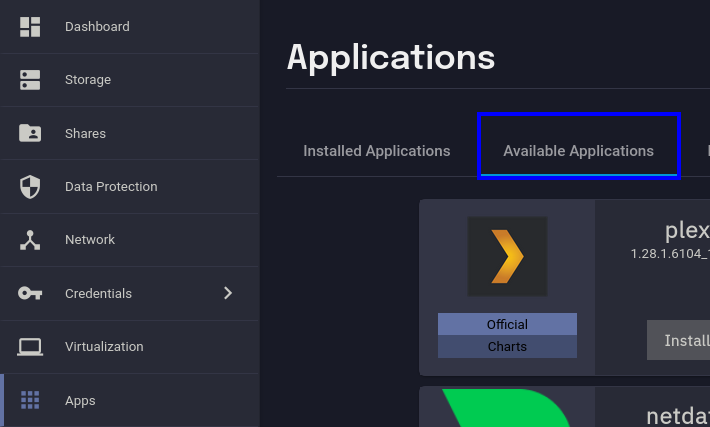

The upgrade went well, we configured a bridged network interface like I have done, installed Plex from the official charts, updated a few share settings, etc.

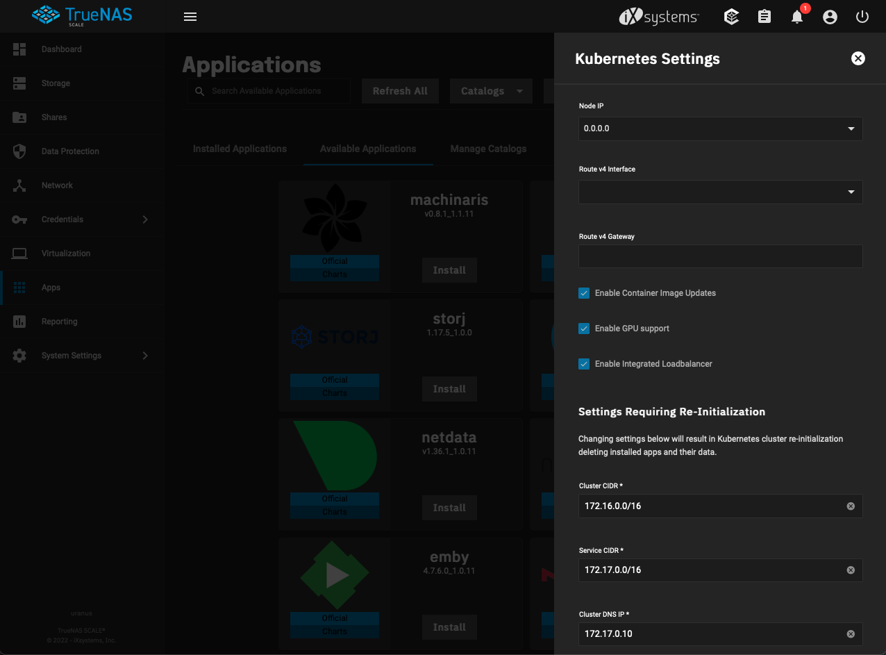

But there is one problem that I can't help with. In Apps, we need to change the IP address assigned for Kubernetes, and make sure the bridge interface is set, etc. To do this we should be able to go to Apps -> Settings -> Advanced Settings.
But the Advanced Settings pane never loads. Nothing happens when we click it. It works fine on my server on the same version. He has tried Chrome and Safari and both act the same (nothing happens when clicking Advanced Settings).

Is there a way I can change those settings using the new TrueNAS CLI? I can see the settings with
> app kubernetes config
but it isn't obvious to me how to change those settings with the CLI. Do I use something like > app kubernetes config route_v4_interface=br0
?Update: figured out the CLI.
> app kubernetes update <parameter>=<setting>
. Would still be good to figure out why the GUI doesn't open that pane, though.
