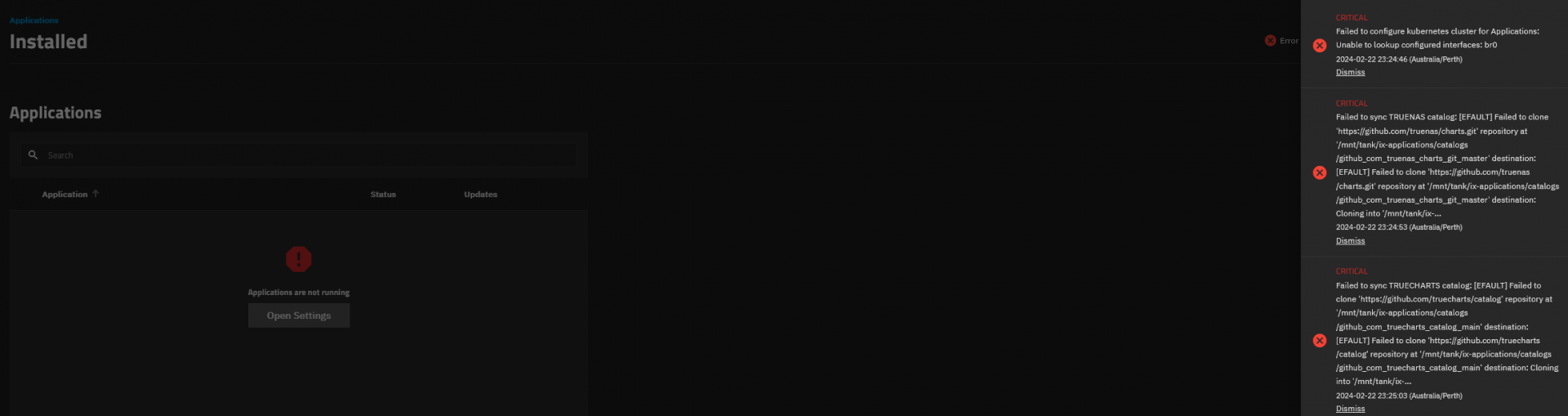

I tried updating to Cobia (.2) finally thinking all key bugs were fixed and then ran into this one. I need to delete the bridge due to the bug with bridging not working after the update, the suggested solution was to delete the bridge interface and then readd it. I can't delete it so I can't fix the issue and the machine does not come up normally afterwards otherwise.
Trying to delete the bridge gives this:
I guess I can start with a clean config but way more work than I wanted to do this weekend, so, reverting for now. But it still needs fixed.

Just a reminder to anyone struggling with this that the Apps page does not seem to automatically update the K8 status or the status of deployed apps in the Web UI (on my instance of TrueNAS-SCALE-23.10.2).
After fiddling with the bridge setting and (after reading the post above) deactivating the GPU support nothing seemed to have changed. But after forcing a web UI reload (CTRL + R), it showed me that actually this config change seemed to have solved my problem and all apps were deploying as desired. Hopefully this helps someone else as well :)

Having the same issue with the TrueNAS-SCALE-23.10.2 without having a bridge configured.
Every reboot ends with:
Failed to configure kubernetes cluster for Applications: Unable to lookup configured interfaces: enp2s0
Unsetting pool and then adding pool again temporarily solves this issue as well as enabling/disabling GPU support. But at next reboot the issue is back again ...
