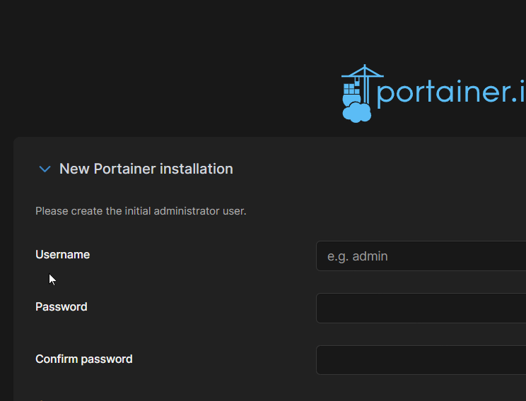

And that worked:
My first successful start of an app in TrueNas Scale
There is still hope.
