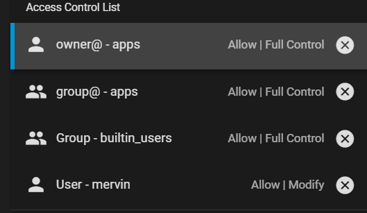

I build a dataset "data" for media and usenet/torrents, and perm set like this

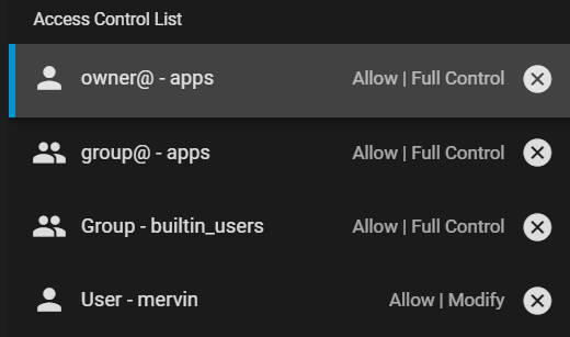

I build a dataset "tc-compose" for True Charts Docker Compose apps (managed via portainer)

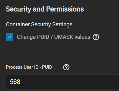

Every docker container either has PUID/PGID set to 568, or not specified (some don't support it)

-My Offical Plex app can not see mounted media in the data dataset. I don't understand how this can be the case as the apps id is a built in user, the built in users group is allow full control
-my sabdnzdb container can not use files in the tc-compose dataset and similarly I can't understand why. it sees the file there but can not read some and can not modify others.

The issue with the sabnzbd container remains in that despite it using PUID/PGID set to 568 (config via docker log) it still outputs permissions errors that it can't write to a dataset owned by 568/568
