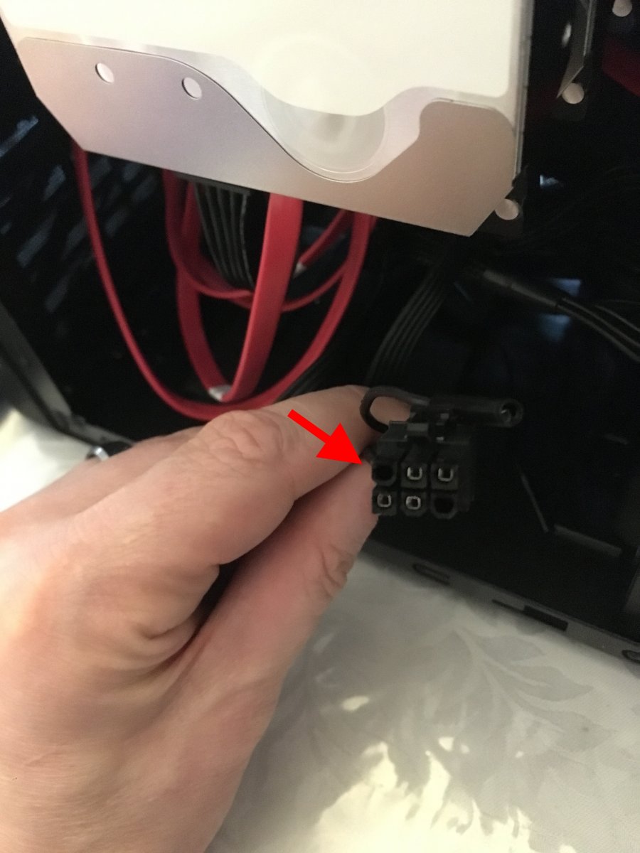

That'll be tough, you should allow 25-30W startup draw for your drives. That'd be 360W for the drives alone during startup, leaving you 190W for the rest of the system. "Probably okay", depending on motherboard and CPU.
With 4TB, you could do this: Buy 8TB or 10TB WD Elements or similar, they are inexpensive. Shuck, make sure not to supply 3.3V to them, and resilver into your existing pool one by one. You'll have double (or a little more) the capacity you have now, and you can eBay those 4TB, and you won't need to worry about physical space, heat, and power draw.
Edit: Pinout repository is at https://www.modders-inc.com/power-supply-pinout-repository/
And this is the pin to be popped out on the PSU side on a Seasonic PSU. Note other brands will have it in a different location.

What is the reason for not supplying the drives with 3.3v? excuse my ignorance but never thought about what voltage was being supplied to the drives.
Yorick
Nov 4, 2018
1,912
Enterprise drives like the HGST HE8 have a feature where they will not spin up when they detect 3.3V, and spin up once 3.3V is gone. That's a feature for staggered spin-up in data centers, because of that initial 25-30W draw. Better to stagger the initial draw and have the PSUs spec'd for ~10W running draw, than over-provision for all drives spinning up at once.
Unsurprisingly, our little hobby boxes don't know anything about that, and although drives don't use 3.3V for anything, still supply 3.3V. Which means those enterprise drives won't spin up. Remove 3.3V, the drives are happy.
That's specific to the He8 / He10 that you get from shucked WD externals; it's not true for WD Red. WD Red will spin up just fine with 3.3V present.
