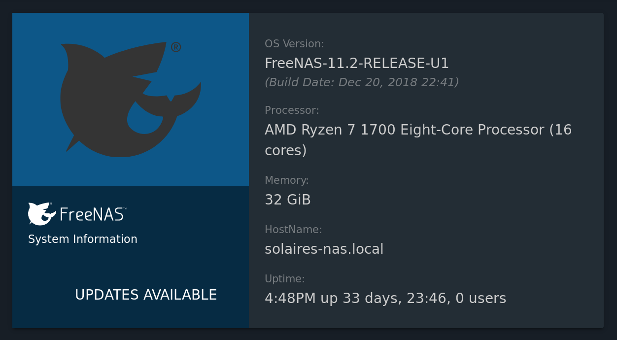

Been reading posts on here and Reddit about AMD Ryzen builds, and thought I'd share mine for anyone who is interested. Below are the specs:
Hardware
CPU - AMD Ryzen 1700
CPU Cooler - Arctic Cooling 33 CO
RAM - Crucial 8GB DDR4 ECC Modules x 4
Motherboard - ASUS TUF B450M-PLUS GAMING
NIC - Intel E1G42ET with Intel 82576 Controller
HDD - Western Digital 4TB Red WD40EFRX x5
Case - Fractal Design Node 804
PSU - Corsair 500w Bronze
Have ran this for over a month now, with the below services:
- SMB shares
- Plex jail of over 10TB worth of content. Have about 1-3 streams of 1080p content, no issues here
- Minecraft jail
- Ubuntu Server 18.04 Bhyve VM for SteamCMD. Runs 7 Days to Die almost 24/7, at peak having 8 players at once, no issues here other than my own messing!
Overall haven't had any cases of corruption, scrub or stability issues. Before this CPU and MB, I had a 7th gen i3 on an MSI workstation mb with the intention of going Xeon, but decided against it to try an AMD build. Didn't regret it and have been running fine since.
Hope this helps anyone looking at an AMD build.
