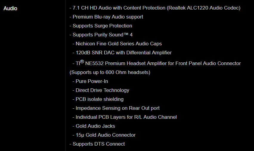

ASRock X370 Taichi happens to have a Intel i211AT network interface. That should be fine, but it still has many other flaws as a server board including integrated (useless) WiFi, Bluetooth, 7.1 channel HD audio... Seriously, just look at how they praise the Audio, and FreeNAS can't use it at all:

If I can find a cheap 2011-cpu for the server board you linked to, that could be a great idea. That being said, If a board has useless features (but still is a cheap and reliable option) that is fine by me. (I.e. Onboard audio on the ASRock board, as long as it doesnt lead to stability issues, i wouldnt care).
