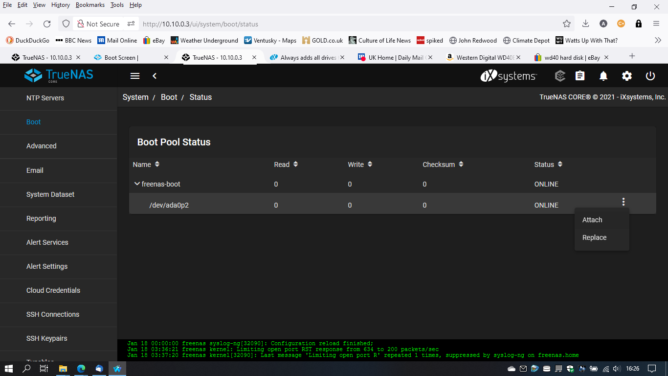

I think you can "detach" from the boot-pool
system - boot - actions - boot status
Alecmascot
Mar 18, 2014
1,177
I cannot show you as I have only a single boot drive but it should be here :

That was very helpful, I was looking at the wrong place. I was able to detach the drives, they became available to create a new pool, all is well! Thank you so much!
