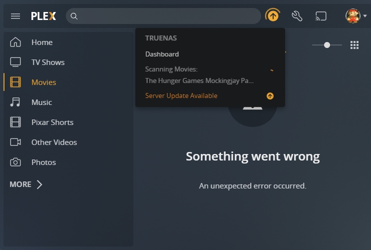

This evening I noticed that I was unable to access my plex library through any devices including web interface.
  • ALL libraries aren't working with either the empty notice or 'an unexpected error occurred' (1st screenshot)
  • Scanning shows file names. (1st screenshot)

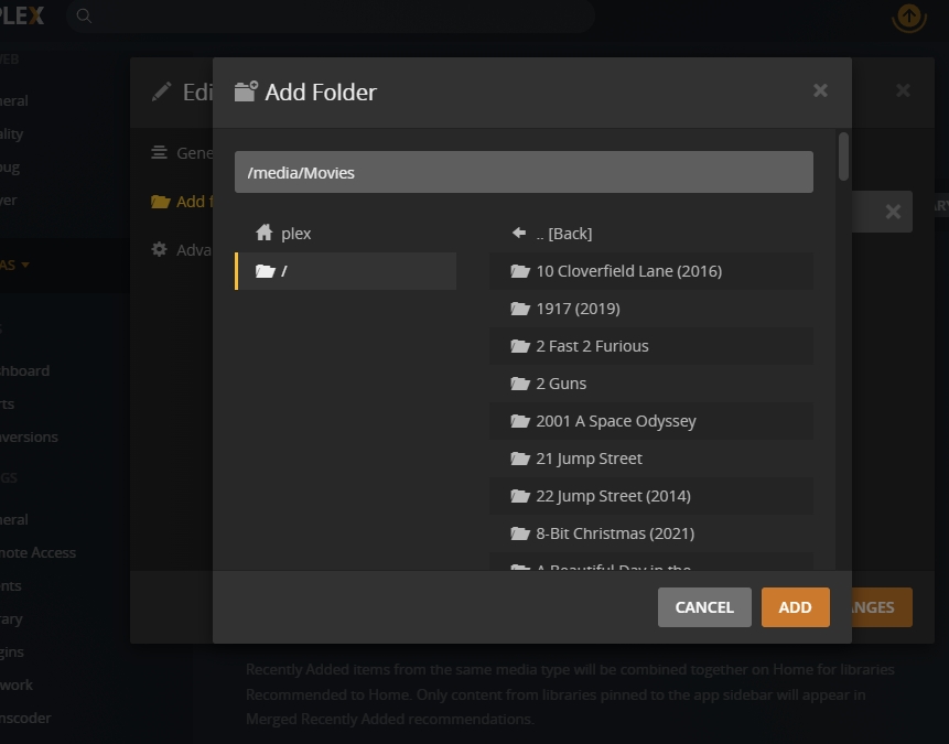

  • When editing the library folder, plex can see files (2nd screenshot)

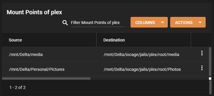

  • Mount points look correct (3rd screenshot), and haven't been changed.

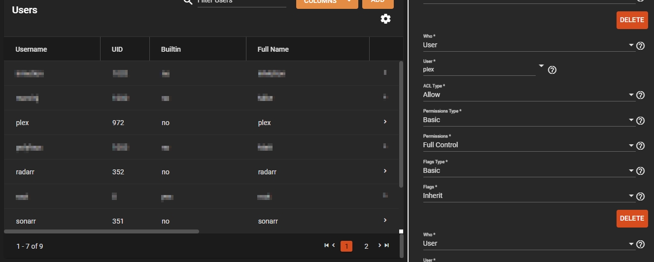

I did reapply the permissions recursively (4th screenshot).
Where did you reapply those? on the media or also on the root of the mount point in the jail? (via chown in the jail)
They were applied via the gui on the entire 'media' dataset.

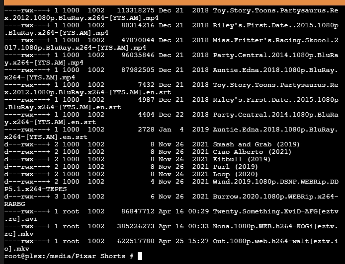

From the Plex jail's shell, I can see files, and I'm able to create & remove folders.
