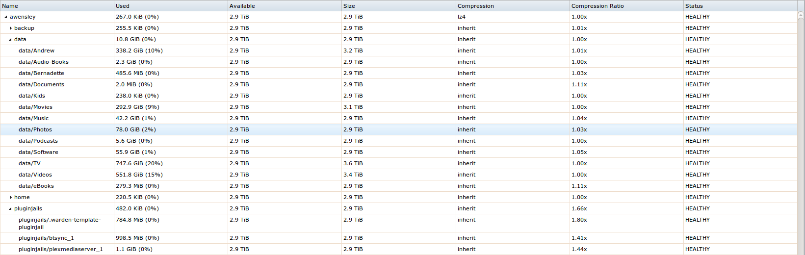

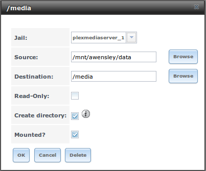

Thanks for the reply. Yes, "data" is mounted on /media in the jail. Here are screenshots of my zfs layout, and jail storage.
Storage layout
Plex Jail Storage

maybe nullfs doesn't span multiple filesystem's (what each of those datasets are). in this case youd need to..
1) mount each dataset under 'data' to a corresponding folder in the jail
2) take my advice and just have all those datasets as just folders in 'data' dataset.

Ok, apparently, I cannot remove storage from a jail. No matter what I do, I can't remove the link between /mnt/awensley/data/ and /media/, which means I can't remove the sub-directories in order to link them individually. I've tried deleting the plugin, the jail, and even the dataset that holds all the plugin jails. Every time I re-install Plex, it remembers that I had storage for that jail and re-links /mnt/awensley/data/ and /media/. Frustrating.
Is there a way to remove storage from a jail? Maybe from the command line?
Joshua Parker Ruehlig
Dec 5, 2011
5,949
from the freenas host
umount /path/to/mountpoint
use the path in the jail so it doesn't umount the zfs dataset, just the nullfs linking. you can use 'mount' to list all mounts active on your system
awensley
Oct 17, 2014
10
That worked! Plex now sees my movies. Thank you!
