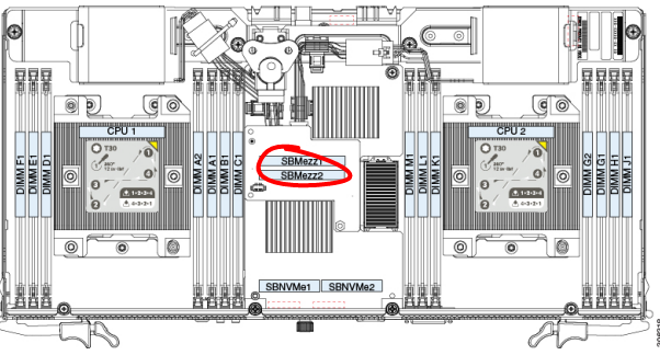

1- Find a new HBA card and it should be compatible with:
UCS S3260 Dual Pass Through Controller based on Broadcom 3316 ROC - UCS-S3260-DHBA
mpt3sas_cm0: LSISAS3316: FWVersion(13.00.08.00), ChipRevision(0x01), BiosVersion(15.00.06.00)
mpt3sas_cm1: LSISAS3316: FWVersion(13.00.08.00), ChipRevision(0x01), BiosVersion(15.00.06.00)
Looks like "LSI SAS 9300-16I 12GB/S HBA" is similar and good choice. What do you think?
As you know our HBA cards are oem and I don't know their form and connection and I'm not able to touch the hardware,
But after a quick search, I found these pictures. Looks like the HBA card in a special form and I don't know can we change it or not.
I only have 1 PCI experss slot and it is using by NVME cache drive. Maybe I will sacrafice the NVME and use the PCI slot for 9300-16i HBA card. Also I don't know the internal cabling, maybe I have to change the cables to use PCI slot location.
Unfortunally, it is not an easy change for me.

I understand but, I can not touch the servers, the HBA card is OEM and I can not use the same place for a new HBA.
The only place is 1 PCI and it means I have to lose NVME cache drive.
Thats why I'm pushing hard.

The question is:
1- Can we fit two HBA in their slots ???
2- Is it possible to use the ONLY ONE PCI x8 slot for HBA, card. This means we sucraficed nvme cache...
This is not a normal server. This server has 2 compute unit, it is like blade server. There is too many tricks the vendor have done with this hardware. I use ZFS more then 10 years I never lost even 1 byte...
