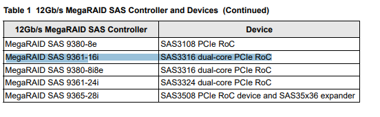

TrueNAS & ZFS do not support hardware RAID controllers:
Most of the time when such a controller is replaced with a plain HBA, the problems go away.

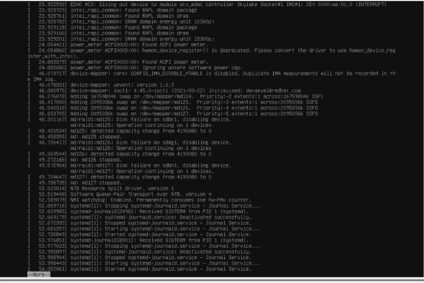

- After Linux and kernel boot sequence, Truenas services starts,
- First truenas tries to mount md swap partition and it is successful. no problem...
- After or before I'm not sure yet, truenas imports zfs pool.
- Few seconds later md swap mount fails and you or mdadm starts a check and the drives being used by mdadm (I think this is the cause of timeout) because I start to see mpt3sas task abort logs.
- After too many mpt3sas task aborts because of the drive timeout, LSI firmware decides to reset the HBA card and we lose all of the drives for 5-10 seconds.
- Zpool suspends the pool as expected and do not continue automaticly. A lot of devices becomes unavaliable for the pool even they exist on the kernel.
- After the HBA reset, When I type zpool clear, I get all the drives but start to see the task aborts again, few sec later hba resets again. This turns to an endless loop. I can not clear the pool, I can not destroy or export.
- After few min later Linux kernel crashes and do not respondes new processes but we can use the shell via kvm. (I'm not sure about crash I have to check dmesg output one more time)

You are mistaken. my HBA card is in IT mode so it is not raid card.

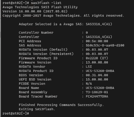

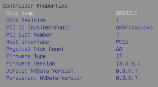

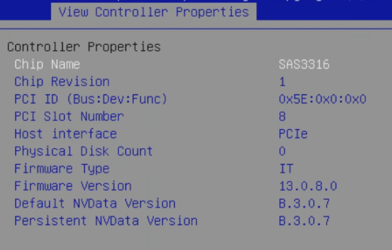

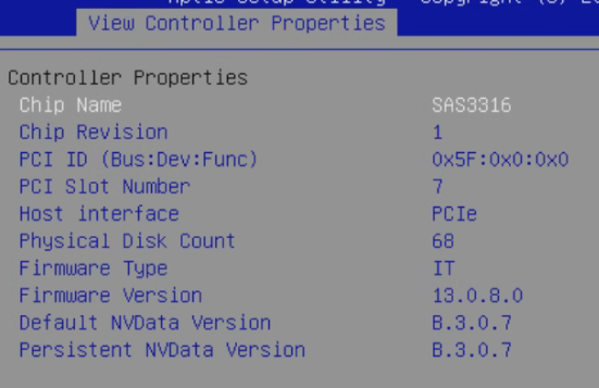

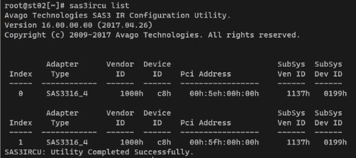

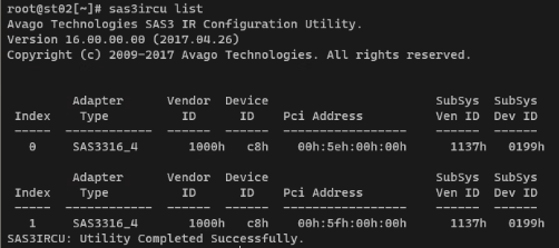

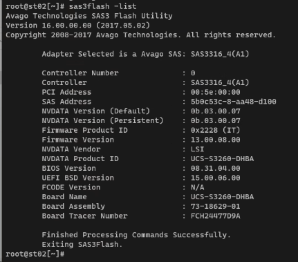

Did you flash it with IT firmware? If you didn't it is you who is mistaken. A RAID controller in "IT mode" is still unsupported.
neofusion
Apr 2, 2022
159
Perhaps the output of sas3flash -list can clarify the current status of your cards?
Edit: And you really should import the pool with id:s instead of device names, since device names can change around every single boot.
I did not flash, it is default and brand new card.
MY storage server: UCS S3260, Firmware version: 4.2(3a) (Secure)
I only have 1 compute unit and the unit's bios version: S3X60M5.4.2.3b.0.1016222320
HBA card is internal built-in default card and the card is:
UCS S3260 Dual Pass Through Controller based on Broadcom 3316 ROC
mpt3sas_cm0: LSISAS3316: FWVersion(13.00.08.00), ChipRevision(0x01), BiosVersion(15.00.06.00)
As you can see in the SS below, the card firmware is IT.
CARD 1:
CARD 2:
To see the HBA card in their BIOS, I have to enable UEFI.
I use legacy because Treunas Scale has boot stuck issue with uefi.
I started to understand your concerns. I stop dealing with hba's 3-4 years ago and I always used default LSI cards.
These cards was not able to have both IR+IT mode and switch between them. So if it is an IT, then it was an IT.
But after you insist, I checked the hba vendor website.
This fourth-generation SAS RAID-on-Chip (ROC), based on its Fusion-MPT architecture, integrates the latest enhancements in SAS and PCIe technology. For OEMs and server vendors looking to build enterprise-class data protection and throughput into their entry to mid-range servers, the SAS 3316 ROC is an ideal, cost-effective choice.
After I read this I decided to flash a new firmware.
Do you have any recommend version and link please?
Hi neofusion, The output:

You don't say whether you have disabled the swap partition slicing that Scale does on disks when creating pools, chopping by default 2GB off the disks.
That 2GB is then mirrored 2x or 3x to create md devices, and a encrypted device mapper volume is created over the top and added as a swap device. These swap devices have to sync up on every boot, causing an IO/CPU spike, possibly enough to interrupt pool import by using up most of the IOPs and a chunk of CPU for the crypto.
Manual pool create, no swap partitions, so TNS systemd swap service doesn't create and sync crypto swap devices.
Webui pool create, swap partitions, systemd service creates and syncs crypto swap devices. IO/CPU spike.
Possible mechanism.
You could try turning of the swap partition slicing IIRC system->swap and there is a setting on the right somewhere. Then use the webui to create a pool, and see what happens on import, if it behaves more like a manual pool, or if you get the same problem, in which case this is probably not the issue.

I'm not sure if just changing the partition type from 8200 to something else would be sufficient for the systemd service not to auto setup swap on the devices.
It's not systemd but the TrueNAS middleware that sets up swap at boot time. It goes a long way to try and establish a redundancy level for swap identical with the one of the ZFS pool. E.g. if you have a single RAIDZ2 pool it will create 3-way mirror swap devices, so any 2 disks can fail.
