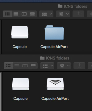

What exact metadata is stripped?
As far as I can tell the only metadata being stripped on 13.0-U1 via SMB are ICNS image data on folders. Created dates appear intact. Alias files appear intact. The weird thing is, the ICNS data is consistently being stripped from the same folders. Only about 10% seem to make it through the transfer intact, but it is consistent and repeatable.

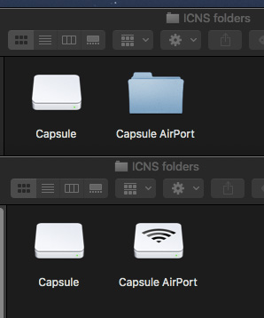

Top is the destination. Bottom is the source.
Steps taken: transferred the folder "ICNS folders" from the desktop to the SMB share via the SMB connection.
About 90% of the folders with ICNS data applied to them end up like "Capsule AirPort" with the data stripped when sent via SMB. But it's consistently the same folders so there must be something different about them that's confusing SMB.
Yes, I have prepared a zip file with the two folders seen above. See attached file. I only included two folders to save on file size but I have more examples if you need them.

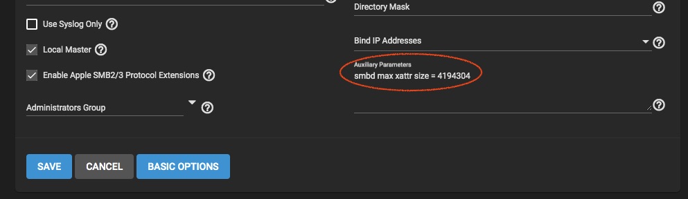

FYI, try setting smbd max xattr size = 4194304 as an auxiliary parameter on the SMB share.
You'll have to forgive my ignorance. I assume this is where the parameter is entered: Services > SMB > Configure > Advanced Options

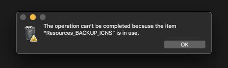

One more question: I'm running into an error when deleting folders with large directory trees. It says:
If I attempt again, it gives the same error. If I find that "in use" file or folder, and delete it, on a second attempt it sometimes allows me to delete the parent directory I was trying to delete or it gives the same error but with a different file or folder. There appears to be a repeating pattern, though. It's the same folders causing the issue. I saw a thread on the topic but I don't see a conclusion. I tried applying another ACL group entry but that doesn't seem to solve the issue. The permissions look identical for both the parent and child directories. Sometimes reapplying the ACL recursively allows for the deletion, but not with the first attempt.
Is this related to the incoming permissions hotfix for SMB?

For some reason putting the auxiliary parameter into the SMB service configuration only worked for one particular share after reboot. The other shares did not take on the new upper bound for xattr size. No idea why.
However, after re-reading your post I realized I put the parameter in the wrong place. So I added the parameter to an actual SMB share instead of the SMB service config. The result was more of the metadata was transferred than before but not all. So I increase the xattr size again and this time it worked for all metadata.
And after applying smbd max xattr size = 8388608 to each share individually, this appears to have worked. Fingers crossed that it will keep working. I will post if anything changes.

Our default takes precedence over the global parameter. You have to do that per-share.
