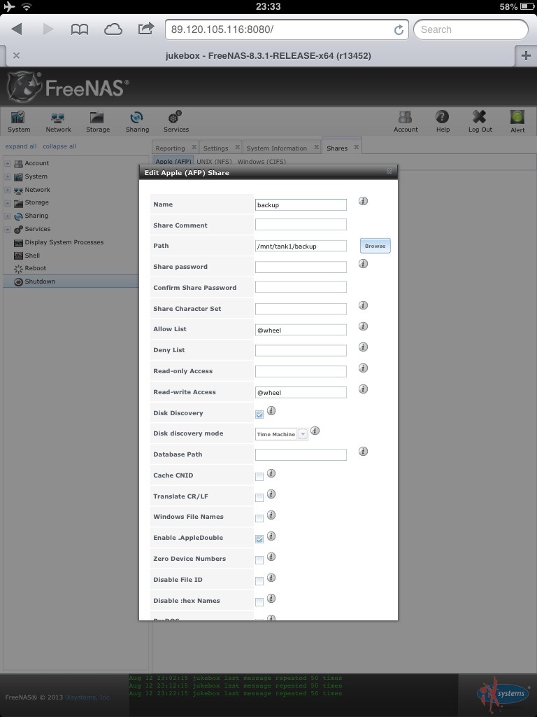

I use 8.3.1p2 without any issues regarding time machine with my mba. Attached you can find my settings.
Hope this will help. My user that i am authenticating with is part of wheel group.
Rest of the settings are the default ones.

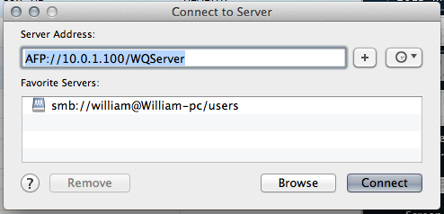

I can not get my Mac to work... CIFS or AFP
I am getting the error,
"items can"t be copied to "folder" becuase you don't have permission to read them. "
I did manage once to get my time machine working with AFP, but then i got the error Time Machine Sparcebundle in use error next time I rebooted.
I just wish this was a little easier to understand... I always considered myself IT savvy till i started this adventure.... I know nothing john snow.
can you put some Screenshots here?

Wyl
Jun 7, 2013
68

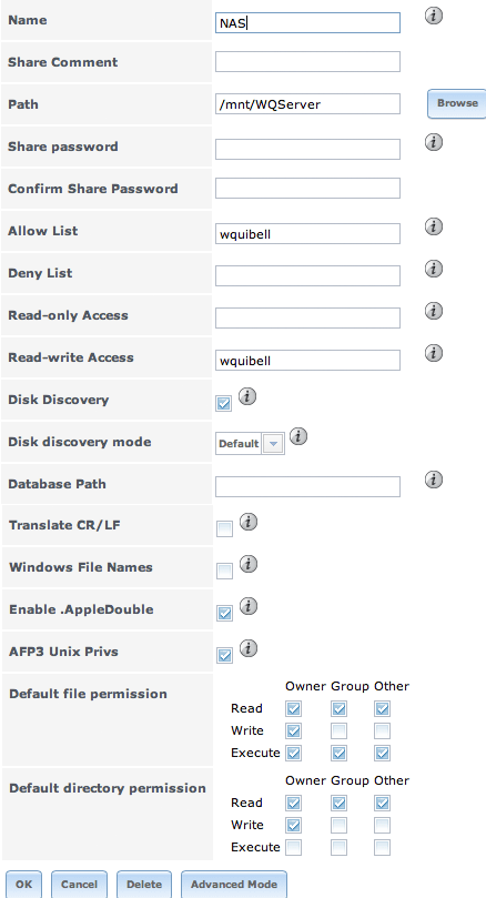

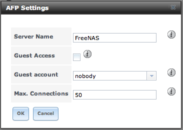

I'll start with shoots of my basic setup following the guide, and then we can more on to more advance issues like TM.
I don't know how to post my console share....
As for connecting to FreeNAS, the CIFS and AFP folders I shared showed up right away in my Finder window under shared... I attempted to put in my username and pass, it seem to except it, but I still have the problems....

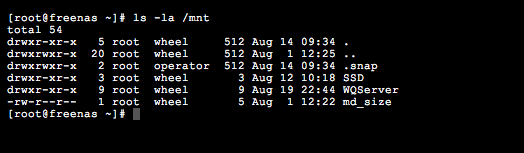

you need to connect via ssh to your NAS (ssh root@yournas.domain) then navigate to the directory /mnt and then ls -la. Now you can take a screenshot and put it here.

Hmm, try please Finder menu "Go To", "Connect to Server" (I'm sorry am German and try to translate German Names to Englisch).
Now open a dialog box, write in it afp://servernameorip/QWServer and klick connect. Now you need to write user and password. Put please screenshot if you see any error message.

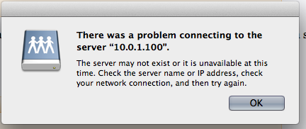

This is my setup... and this is my error...
ObiTobi
Jul 12, 2013
316
Never write "AFP". "afp" is correct try again.
And I see now, the WEB-Interface has a point "Shell". You can navigate to your /mnt directory and put here the ls -la output

Wyl
Jun 7, 2013
68
same error with lower case....

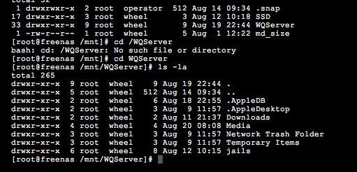

*edit*
I got it...
see attached....

Ok its easy, do you have no permission for this filesystem.
The easiest option is to change the owner on filesystem.
Go in to the Shell to /mnt (very important !!!) and then type chown -R wquibell WQServer
As last show if the afp service is running - you can stop and start it.
OK, now type in your shell "tail -f /var/log/messages" and try connect from your mac. If you see error again - put the screenshot from this "tail -f" command.
