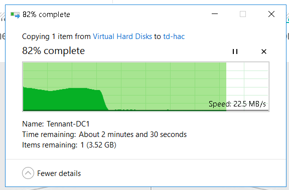

Sustained throughput seems to be nonexistent however, and do not recommend:
I likely will be returning these and biting the bullet on some Chelsio T520s and fiber DACs when I can afford
Hold your horses; what's the rest of your system configuration? A long period of high speeds followed by a drop to a slower rate usually indicates that you've exhausted something else in your setup (likely your vdev/pool throughput) and this wouldn't be solved by the Chelsio cards.
ee21
Nov 2, 2020
33

Oh, and the file copy was done from a Windows host, if not obvious, using an iSCSI volume, stored on a zvol extent on the TrueNAS

22.5MB/s is a pretty big dive to hit for an all-flash setup, but this could still be the write throttle. I'll circle back on this when I can get to a full keyboard and provide some scripts and CLI commands you can use to confirm.

So a bit of napkin math says that you were copying a 20GB file (a VHD/X, probably) and looking at the chart your transfer speed choked at the 30-32% mark, or about 6.4GB into the copy job. With 64GB of RAM you're at a max dirty data of 4GB. I'm thinking your SSDs are choking up under sustained writes (consumer SSDs are made for sprints, not marathons) and eventually you're just getting choked out by the write throttle.
iSCSI will also be chopping your files up into smaller records - the default volblocksize of 16K means a lot more I/Os to your pool than the default 128K recordsize.
Here's a dtrace script, save it on your TrueNAS machine as a file (eg: "dirty.d") and then run it with dtrace -s dirty.d YOURPOOLNAME and start a transfer. Watch for the correlation between transfer speed dropping and dirty data climbing.

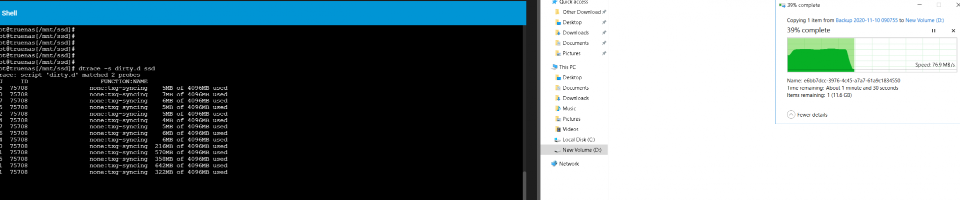

Correct, ~20GB VHDX. I thought the Samsung SSDs were able to handle sustained writes at near max speed without throttling due to cache/write throughput, but thank you for the script, I will test!
I'm not entirely sure what you mean by a max of 4GB dirty data? Where did you get that based on 64GB RAM? I thought the whole point of the ZFS cache was that writes could be dumped in at full speed and then flushed to disk? When running over a 1G connection, writes typically are sustained at 115MB/s without any sudden dives, if that tells you anything.. Oh and just out of curiosity, I felt the little heatsink on the card during an idle workload, and it was burning hot to the touch, I'm going to try some active cooling and see if that makes a difference.

EDIT: Ran the test, very interesting results, I'm happy at least it looks like my pool isn't at fault.. Time to ditch the NIC?
