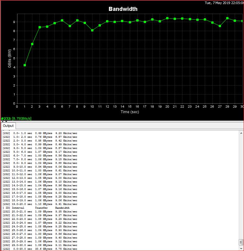

There are also some performance stats.
iperf default settings (TCP protocol).
average speed: 9 Gbps
CPU load: 38% (17% system, 21% interrupt)
Server:
OS: FreeNAS 11.2-U3
CPU: i3-6100
RAM: 40 GB
LAN cards: Edimax EN-9320TX-E (both server and client)
Client:
OS: Win 7
CPU: i5-4570S
RAM: 16 GB
switch: MikroTik CRS317-1G-16S+RM with 2x S+RJ10 SFP+ modules
cables: 2x Cat6 UTP, 3m
Tehuti drivers can be downloaded here:
http://www.tehutinetworks.net/?t=drivers&L1=8&L2=12
Screenshots attached

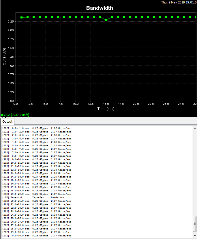

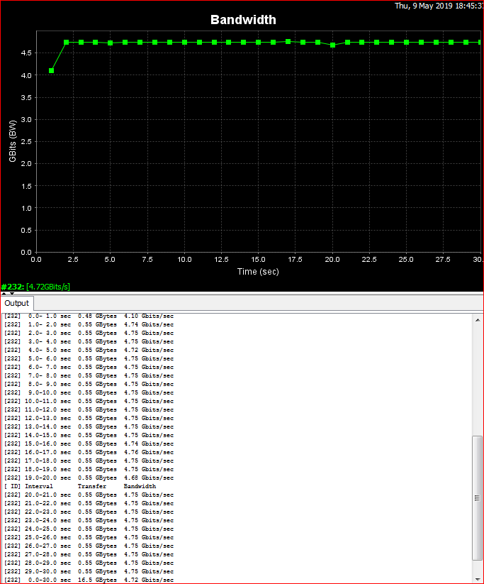

Edimax advertised EN-9320TX-E card as NBASE-T compatible (and Tehuti reference card TN9710P also). Just in case, I set Windows drivers Link Speeds from Auto to 5G and 2.5G, iperf results (hardware same as in 10G tests):
5G speed: 4.72 Gbps
2.5G speed: 2.37 Gbps
Only difference was, that when I run iperf from FreeNAS Shell and tried to switch to System Processes Menu in FreeNAS UI, it breaks iperf server. Now I have FreeNAS 11.2-U4 installed (10G tests, when switching between Shell and System Processes works was run from FreeNAS 11.2-U3 version).
Was there something broken in FreeNAS 11.2-U4 UI Shell/System Processes implementation?

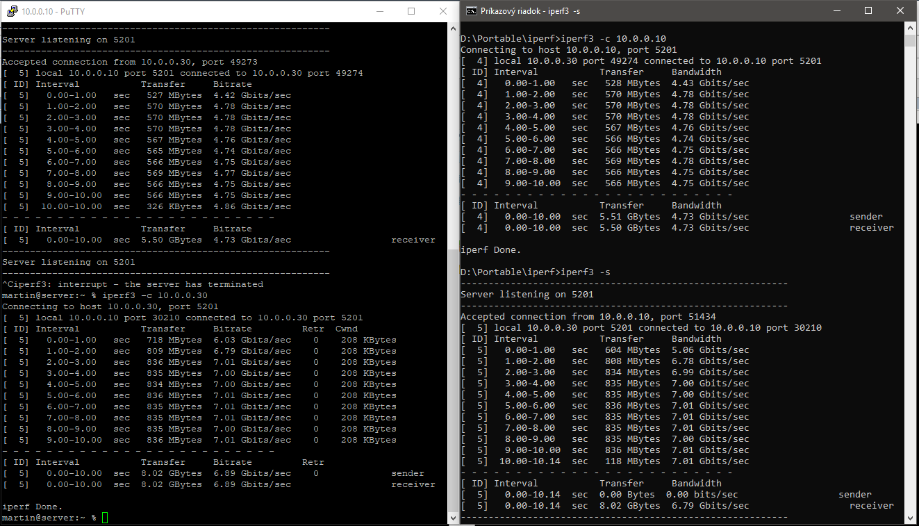

Hello,
I am newcome to the FreeNAS. My test with Tehuti gave results on printscreen...
Tehuti on FreeNAS-11.2-U4.1, AQuantia AQC107 on client with W10 1809.
