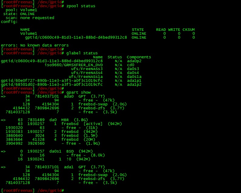

Please post output of:
zpool status
glabel status
gpart show
programmer01001
Jan 29, 2014
12
I've uploaded the screenshot

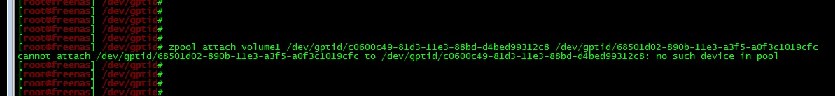

OK, so you need to run:
zpool attach Volume1 /dev/gptid/c0600c49-81d3-11e3-88bd-d4bed99312c8 /dev/gptid/68501d02-890b-11e3-a3f5-a0f3c1019cfc
As you did not paste the data but attached a screenshot I may have mistyped the GUIDs. The first one should be the one from zpool status the second one should be the ada1p2 GPTID from glabel status. To make sure that you got them right just copy & paste them in the shell.
programmer01001
Jan 29, 2014
12
Unfortunately I have the same error. Can it be a bug?

I just tried in in a VM and it worked. Are you sure you aren't mistyping something? Letter O instead of number 0, ...
Can you please copy&paste the output of zpool status and glabel status and the command you are trying to run (instead of attaching screenshots)?

No mistyping, because I'm copying the gptids from following command outputs.
