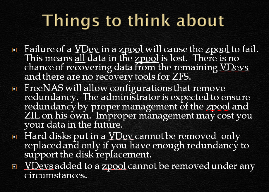

You are welcome to try it. But because of how ZFS works with its structure and stuff, do not expect to find much, if anything. There's a reason why my noobie presentation has this slide in it...
You literally are exactly what that first bullet was meant to avoid. :(
Thanks alot man, wish i'd read it, im the type that never reads instruction and just do it myself guy.
