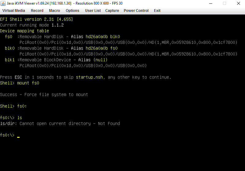

I am now able to boot using UEFI, but when I mount the drive and type is ls to display the content, i get "Cannot open current directory - Not Found"
Below is an image

Marcet
May 31, 2013
193
It must be a problem of partition table on the usb stick. Is it GPT ?

Marcet
May 31, 2013
193
I'm not sure EFI Shell can mount MBR disks. Try to reformat your USB stick using a GPT partition table.
