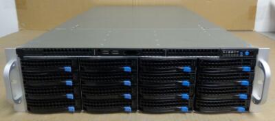

First server I found with specs of interest copied below:
1. It seems quite beefy and I have no doubt it'd do the trick, but I kind of wonder if it's overkill for my purposes? A counterpoint is it leaves room to expand without acquiring more hardware down the line.
2. Is the hardware particularly old or energy intensive? How long should I expect before I should look at upgrading? The CPU isn't as ancient as my PowerEdge, but it's from 2013 and I wonder if it'll soon be obsolete, and the TDP is a bit high (130W). I'm already planning on removing the second processor unless it becomes apparent I'd need it. I understand someone asked about a vaguely similar server in 2018: https://www.ixsystems.com/community/threads/advice-on-used-supermicro-build.69900/ and the hardware guide seems to imply the hardware should still be good. Does that still apply?
3. Are there different generations of the 836 chassis? Is there a risk I'm acquiring a model that's obsolete for whatever reason? Searching for the specific chassis of the server, I found this page on SuperMicro which says the product is a "Discontinued SKU". https://www.supermicro.com/en/products/chassis/3U/836/SC836E26-R1200B
Second server I've found given my concerns, and at half the cost, but less hardware of course:
Is this a good/bad choice, any suggestions, or I being ridiculous? Thank you all, I greatly appreciate your help!
