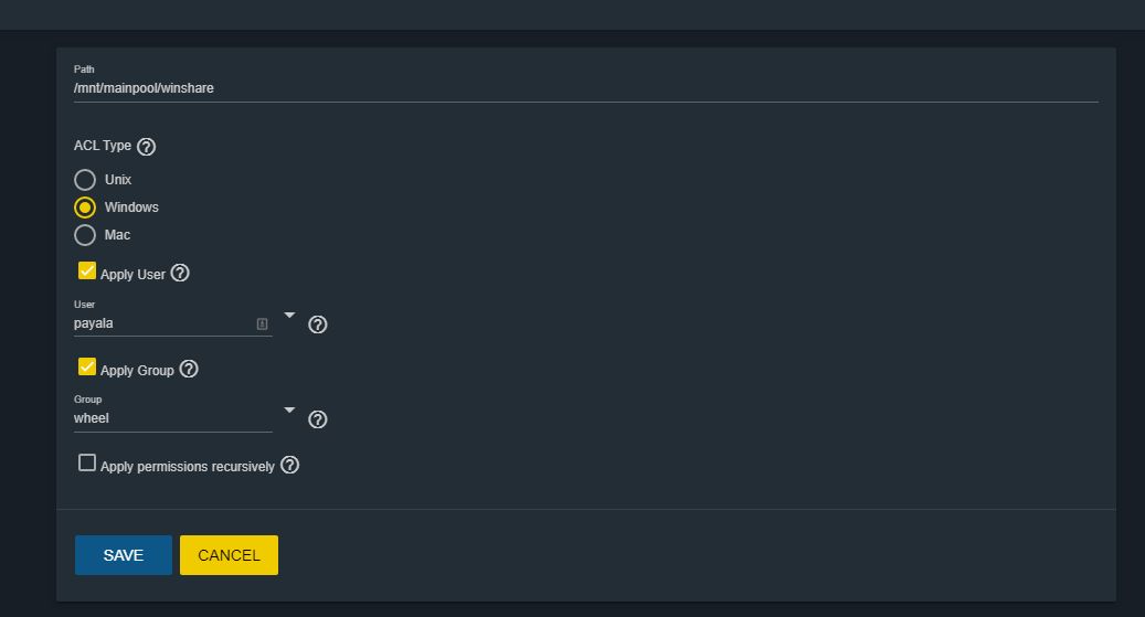

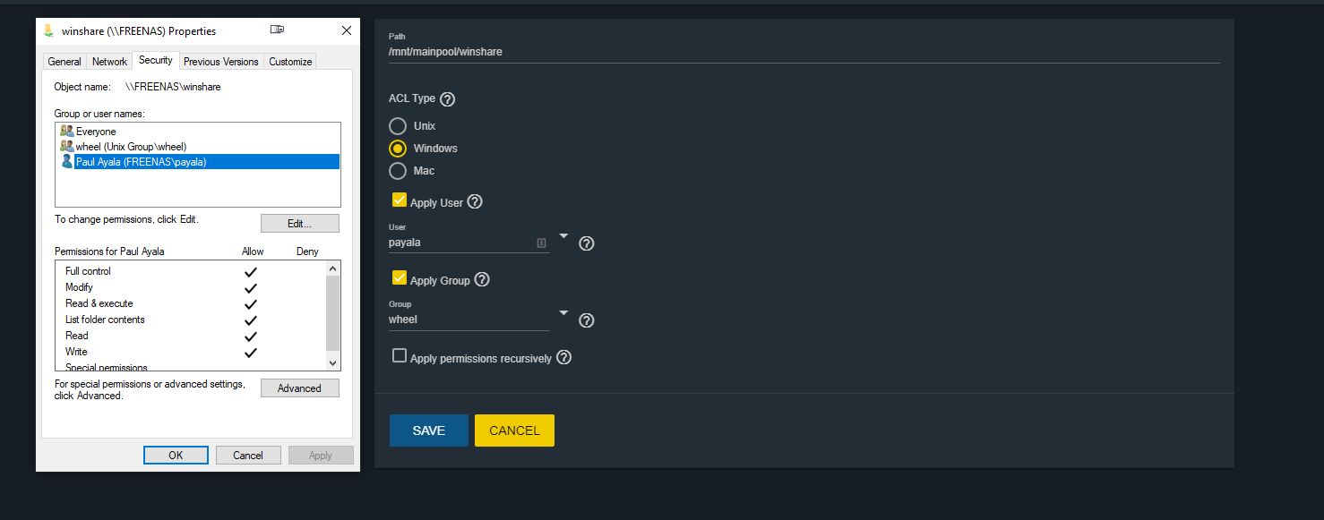

I hate posting this as hasving searched so much i know the answer is out there, i just dont know what it is. In simple terms my whole freenas box has a single share at the moment which i mainly use from a number of Windows clients. As i experiment with Linux i guess this will take over, at the moment i have setup Proxmox and in an Ubuntu container i want to access my share for media. Based on what i have read it will be a share issue but i am unsure where to start here. Output of some commans i have read of the forums...

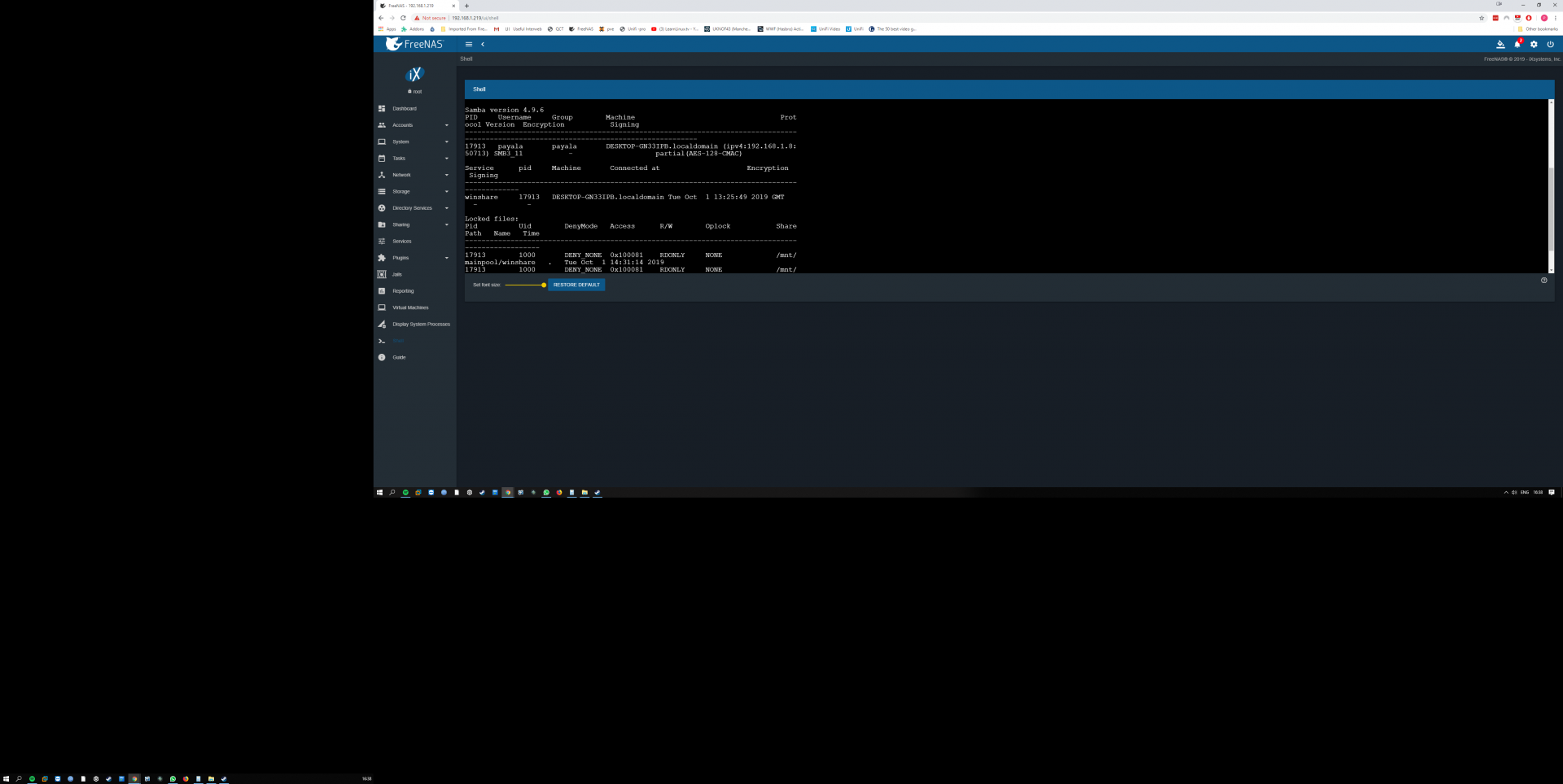

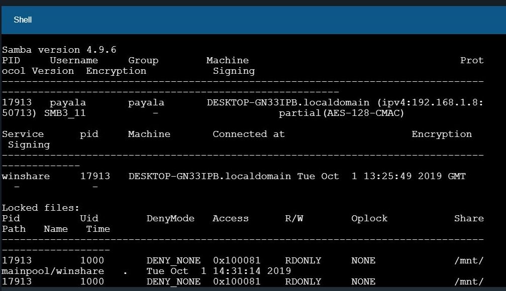

From Freenas
I amssume this is something to do with permissions or the SMB2/SMB3 thing. Can you point me in ther rigfht direction please.
Regards
Paul
