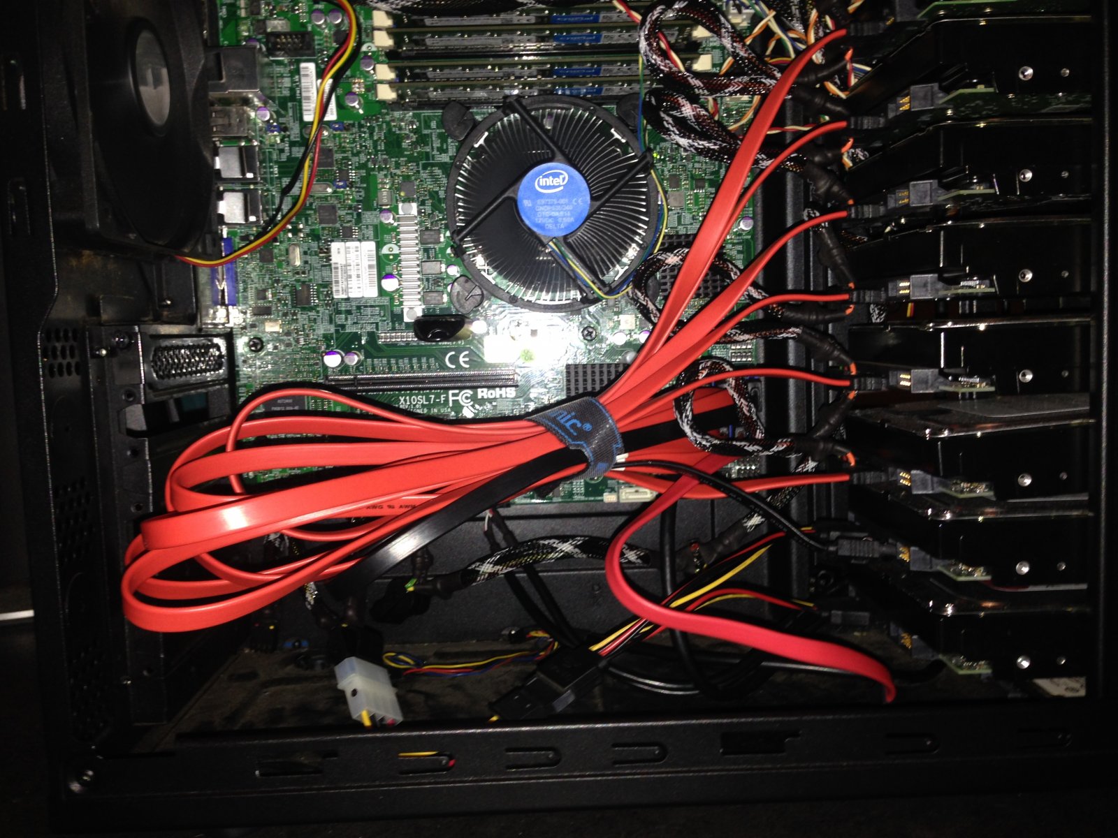

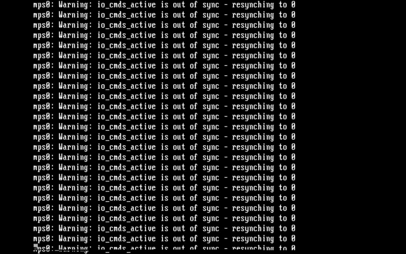

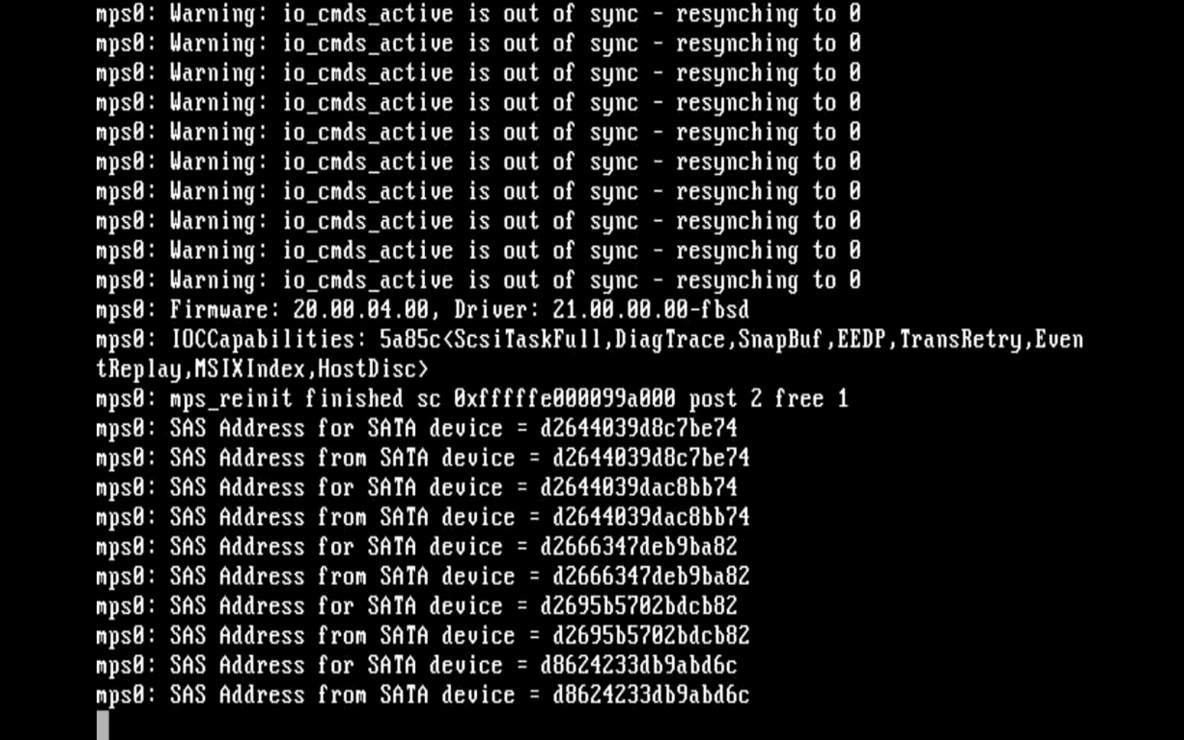

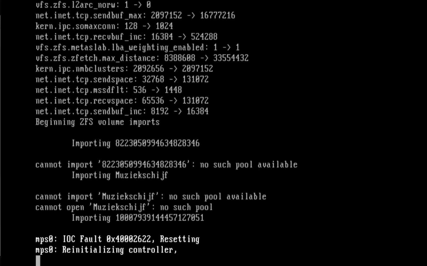

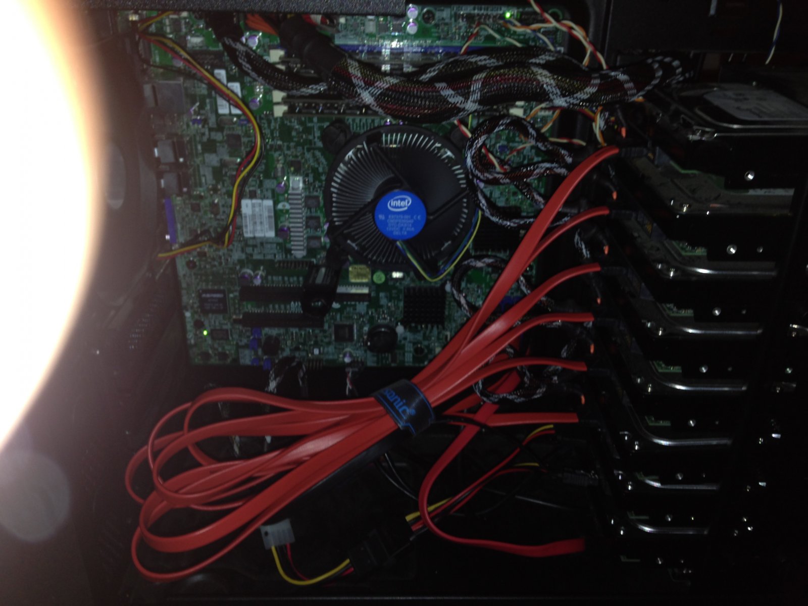

I made a few photos but I doubt you will be able to tell there is shorting on any photos I make. I'd have remove the motherboard again. I do have another case, I could try to run it in that, but that would take some time. Currently it is 2:45 AM here, I'll be going to bed now, if I'm going to try that it will have to happen tomorrow. Meanwhile the memtest will run. I apologize for the mess with cables, I would have made it a little more neat, but after swapping out the motherboard so often I just stopped caring about it. No wires are touching the chassis and airflow is also barely obstructed. Note the drives are also currently not powered even though they seem connected, I disconnected the cables from the PSU. I don't want to risk the memtest failing as a result of issues with SAS controller even though it would be unlikely. I also added some photos showing the actual errors, might be useful in determining the source of the problem. They are actually old screenshots, but they show the exact same error, only now not during boot, but that is only because now it is not trying to import the volumes during boot. Here you go:
First the crash:
System photos:
First the crash:
System photos:
